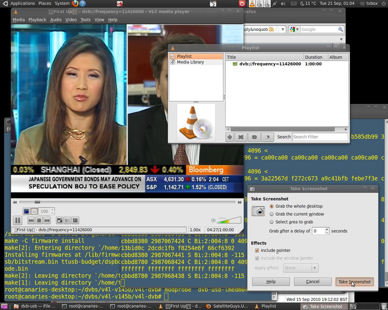

1ADAM12-
Yes the driver does work with VLC, but the application is quite buggy. There is a small bug in my driver that may stop it tuning correctly certain frequencies.
Always select budget from the advanced settings. The player stalls on initial start, but can be restarted from right clicking play list.
see pic

Most excellent.
Ubuntu / VLC / QQ Box all working.
In another thread here the question was raised if VLC tunes DVB. I never was able to get it working in Vista with QQ Box.
With your detailed instruction I could do the same.
Cheers,
Adam
PS: Could not get patches or how to install on your Google page to work.
