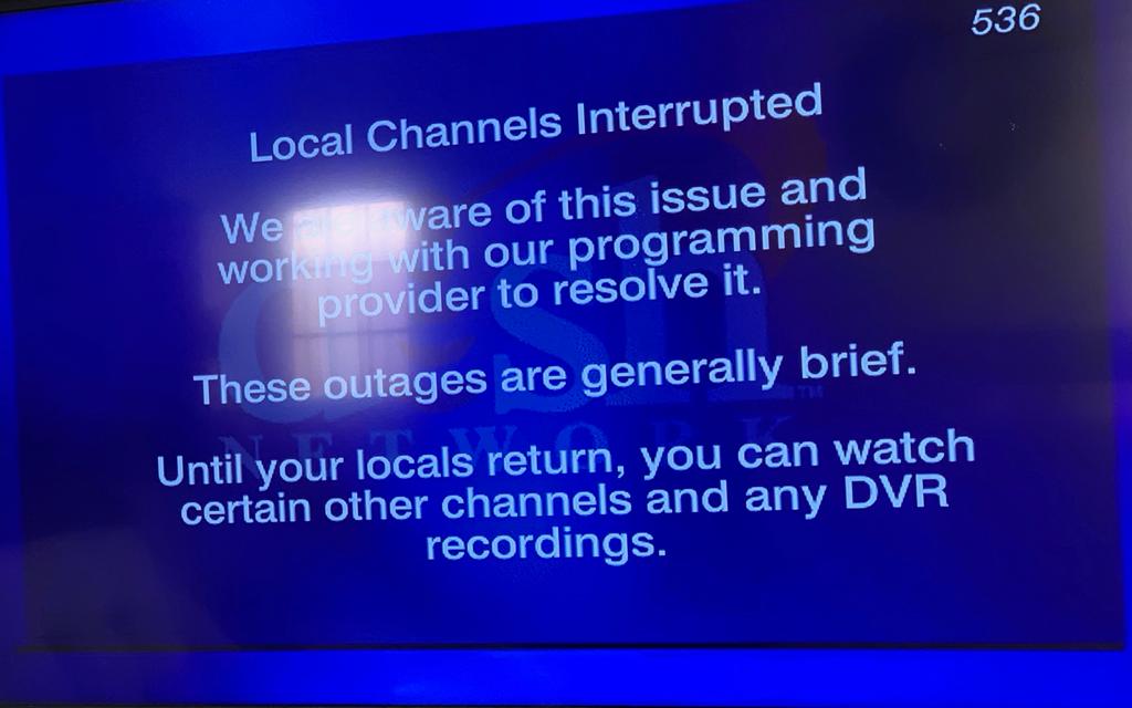

A customer from LA is on a trip thru Baja, Mexico, he is now at Bahia de Los Angeles, Baja California, he mailed me and told me that he cannot get LA local channels.
I checked at Lyngsat.com, and it says that LA locals are on 119 sat (CONUS) but seems like he cannot get these channels for unknown reason.
He sent me some pics showing all LA local channels on the screen, but at the time he pick one, the screen goes black, and satellite signal error message appears on the screen.
Here are the pics he sent to me

Willing to bet that the LA spot beam does not extend that far south.

The LA locals haven't been on a CONUS feed for some time now. I believe the only California CONUS locals now are the Sacramento DMA on 119.

Just use the "Upload a File" button at the bottom right of the edit window, Henry. But in this case it isn't really needed, since we know he's out of spot beam range for the LA market anyway.

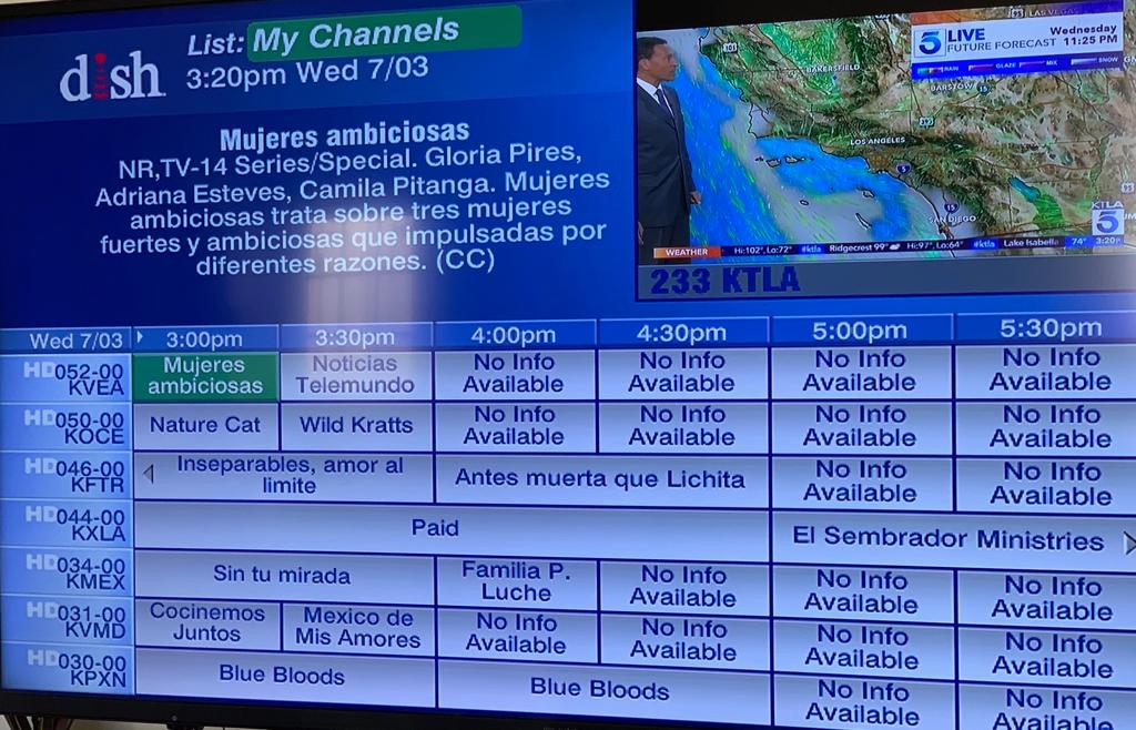

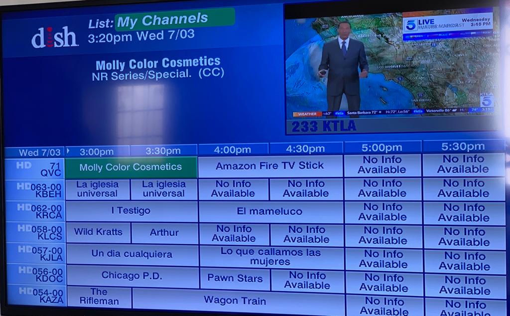

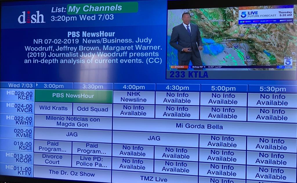

You can see on the photos all the LA local channels are listed on the channel guide, but no one is avalable...Crazy, isn't it?

In 2017, Dish was offering a DNS (Distant Network Service) for RV'ers and truckers that allowed receiving the LA locals anywhere in the country for a fee. Subscribing to DNS meant you didn't have to keep changing the locals as you traveled to get the network programming. They've stopped offering DNS, but they may still be servicing the grandfathered subscribers. My understanding is that it was dropped due to lack of subscriber interest. As easy as it is now to change the service address, I'm not surprised.
Henry, it occurs to me that your friend might be able to get the San Diego DMA locals by changing his service address.
It is 335 miles from San Diego to Bahia de Los Angeles as the crow flies. Somehow I doubt it but you don't know until you try.
Yep, that's why I said "might be able...". I didn't take the time to dig out the spot beam maps to see what the chances would be. Now that I have checked the footprint maps, San Diego, Tucson, and Yuma are all well out of range for him. Sacramento's CONUS feed is a really iffy maybe.
