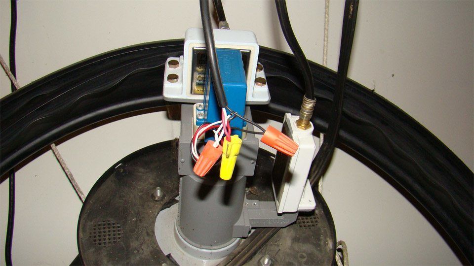

The dish does have C and Ku capabilities (I took some pics of the lnb's today) see attached.

I will check this out. I'm not totally sure what's on my dish at the moment, but I'm willing to add new parts. The thing is I can only have one dish (not a farm of them). So I was looking to do as much as I can with one. I'm not even sure what my full options are, there is so much information here.

By going with a newer LNB that does not require a polar rotor, as Anole has suggested, you'll also save yourself having to run an additional cable from the receiver to the rotor.
What would you recommend?
