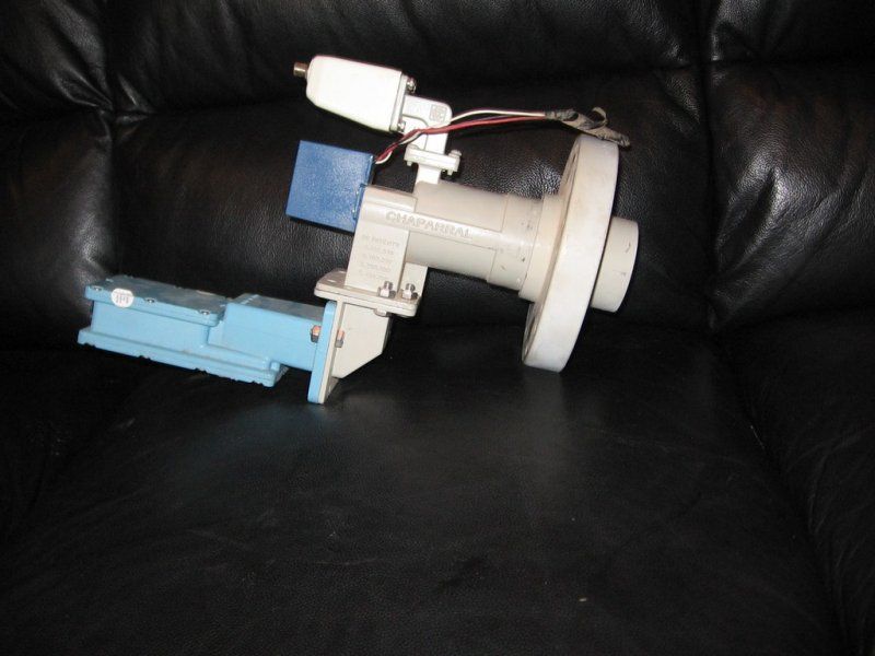

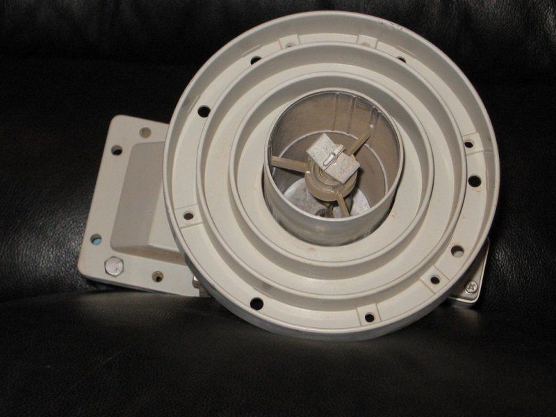

Take some pictures of the end of the dish. Does it have a polarotor? You may need a new one of those also, if so.
You need to run through the whole system piece by piece.

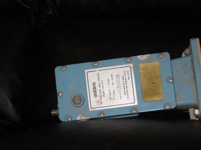

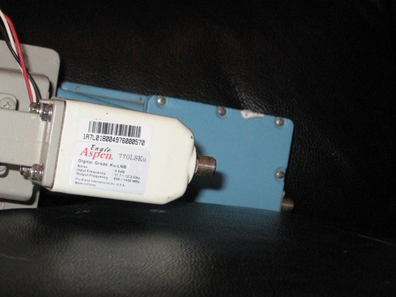

Do you have 18 volts at the LNB coax cable? If not, check at the back of your receiver.
If you have voltage at your receiver, but not at the LNB, your coax cable needs to be replaced!
This is what I would look for first!
Here are pics of what was on the dish.
I don't know about the voltage but when I scan across satellites the snow changes as does the signal meter. Is that any indication? I have a disability that keeps me from doing the hands-on stuff myself but I have friend that helps. I may not be able to get a quick answer back on some of your questions as it'll be according to his schedule.
