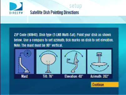

Could someone plug in my zip (60640) and give me the elevation, azimuth and tilt off their HR20?
I am putting up the Slimline dish today but the HR20 won't arrive till Monday.
Can I use the coordinates of my HR10-250

Here you go, see the picture below. :)

You guys are so fast I couldn't even edit my no coffe spelling fast enough. :p
Thanks :bow
