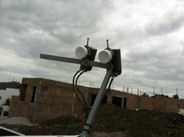

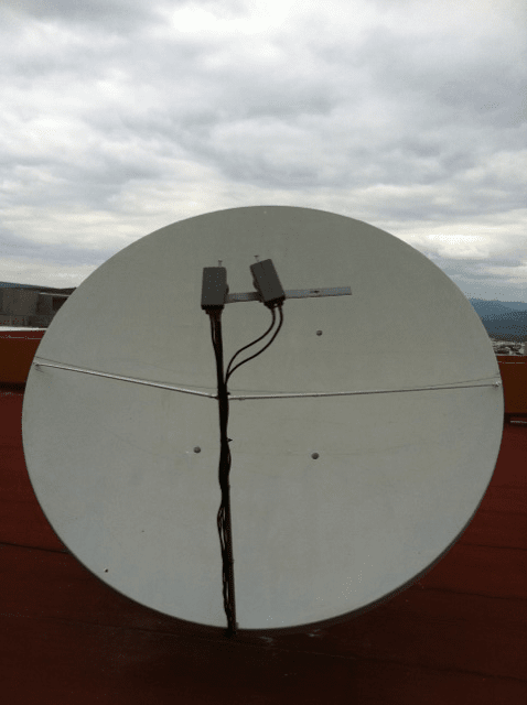

I AM using a 2.40m round that I used for Dish Network. However signal is strong that the one u have is goods enough! The first Satelite is quite simple to find as you just point the dish. The second one at least for me was a little more complex, as it depends on the bounce off the dish which is on the side. So you use 100% of the dish on one sat and partial on the other... If you have an installer that knows Shaw it should not be a problem.

Imt2011 said:
Forgot to mention, yes one dish and 2 lnbs, and a piece of metal (bar) to hold the second lnb on the side.
When you have this lnb set-up install, post pics. I also am tying up 2 large antennas and would love to put all Shaw on one antenna.
FYI photos of install
Imt
Imt
Great pics! I will try to do something similar this weekend. I don't really have anything to point at with my other 3 antennas yet, but getting all SD on one antenna is a good start. I'm only hanging on to SD for the networks and NFL in HD as much of the other programming seems very repetitive and basic coming from a E* 3 satellite installation. Thanks again!
