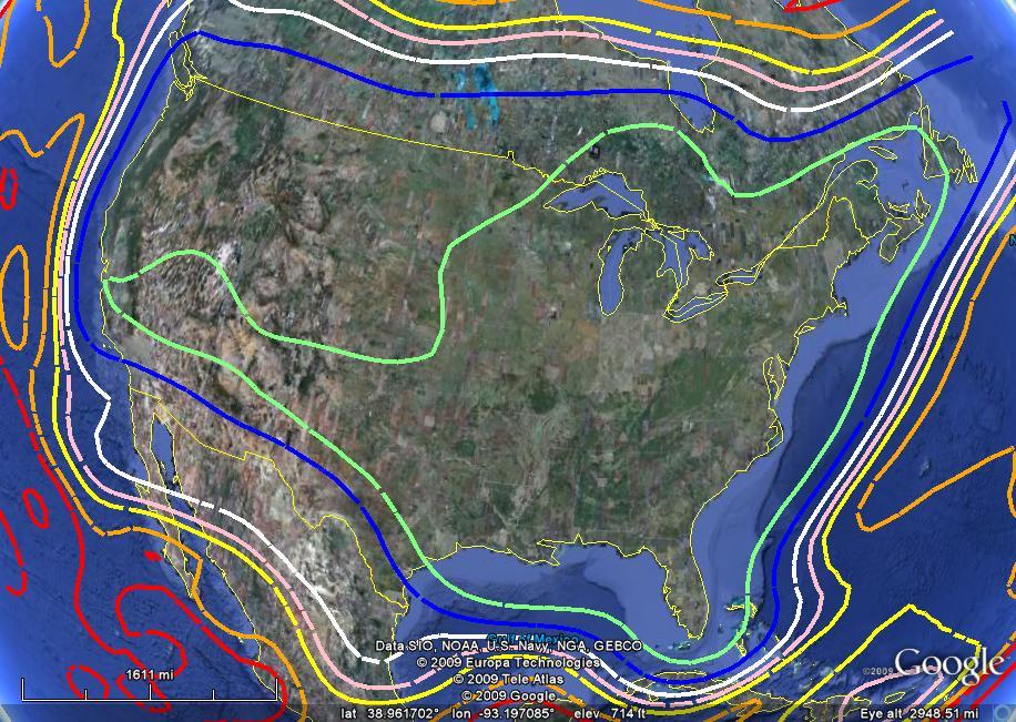

Anik 3 has a fairly decent signal in most of Conus with a small band along the southwest border of the country being a bit weaker. Something like a 20 inch diameter antenna should bring in a decent signal in most of the country.
