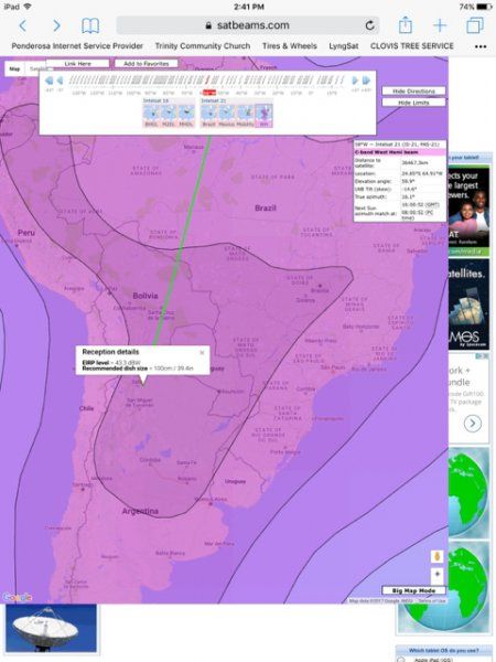

Hi , a Dutchman living in Salta , Argentina is asking at a Dutch board what C dish size he needs to receive CVC - La Voz (radio ) at Intelsat21
Anyone can help out ?
I'm in North America and I only have a ku dish, but from what I can see Intelsat 21 is at 58 degrees west with a C band global map. I couldn't find that specific channel, but if it is on that satellite it should be able to get anywhere in North America or South America with a 8 to 10 foot (2.4 to 3.0m )dish.
Hopefully someone with a C band dish in North America can tell you if that channel is actually there.

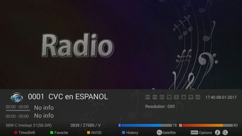

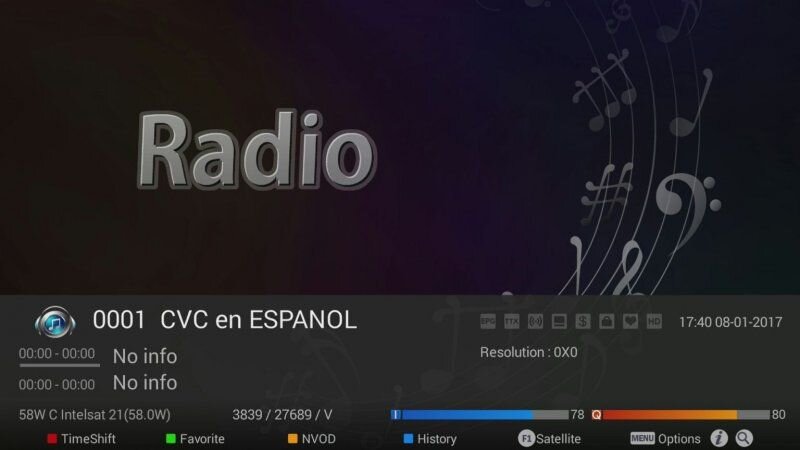

I've just scanned it here in the UK (strong on my 1.8m) and as mc6809e says the parameters that Lyngsat give show it as CVC en ESPANOL.
Reactions: mc6809e
