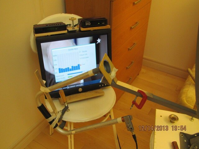

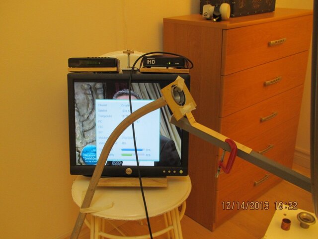

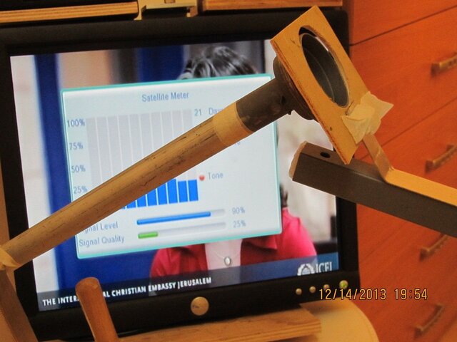

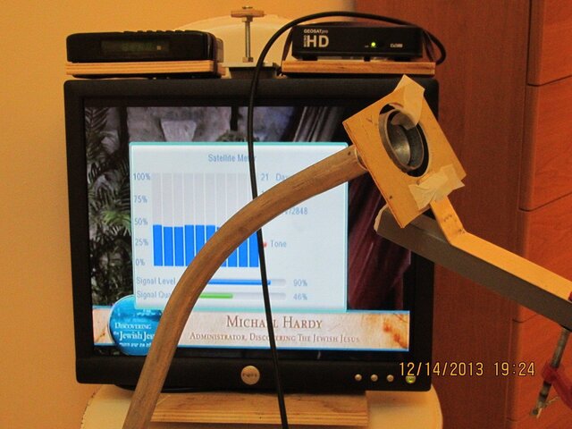

Trying to add waveguide between LNB and its scalar
Cold and snowing outside, but now it is possible to do some experiments with waveguide, in comfortable environment...
32" long pipe does not reduce signal Q, but another pipe with two ninety degree bends reduces the Q by 15 - 20 %.

View attachment 93469View attachment 93470View attachment 93471View attachment 93472View attachment 93473
I don't know if it would make a difference or not for satellite signals, but do you have any rectangular pipe, conduit or whatever that you could try for your waveguide instead of round pipe? I've seen and worked with microwaves in other applications and the waveguides are rectangular, not round. With the rectangular, you may be able to make a 90 degree without losing signal, possibly?
Don't know for sure, I've never done work with low power microwaves like satellite signals to the point of building waveguides, only high power, but it might be worth looking into. Different diameter pipe may change your loss too, Ku, 0.622 x 0.311'', C, 1.372 x 0.622'', somewhere close to around those sizes, I think.
