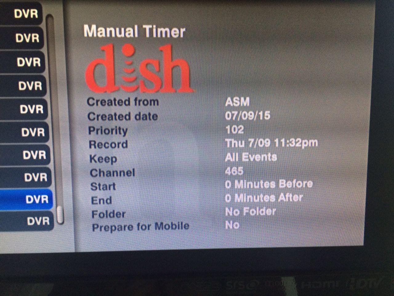

Extra weirdness. Did you go onto my Hopper and create a test timer for tonight? See image... I didn't do that (what does ASM mean?) and I see that 465 is a PPV Sports channel.
There is one of those promotional recordings that will hit all hoppers soon. I didn't look at the date last night, but deleted the timer when I saw it.
