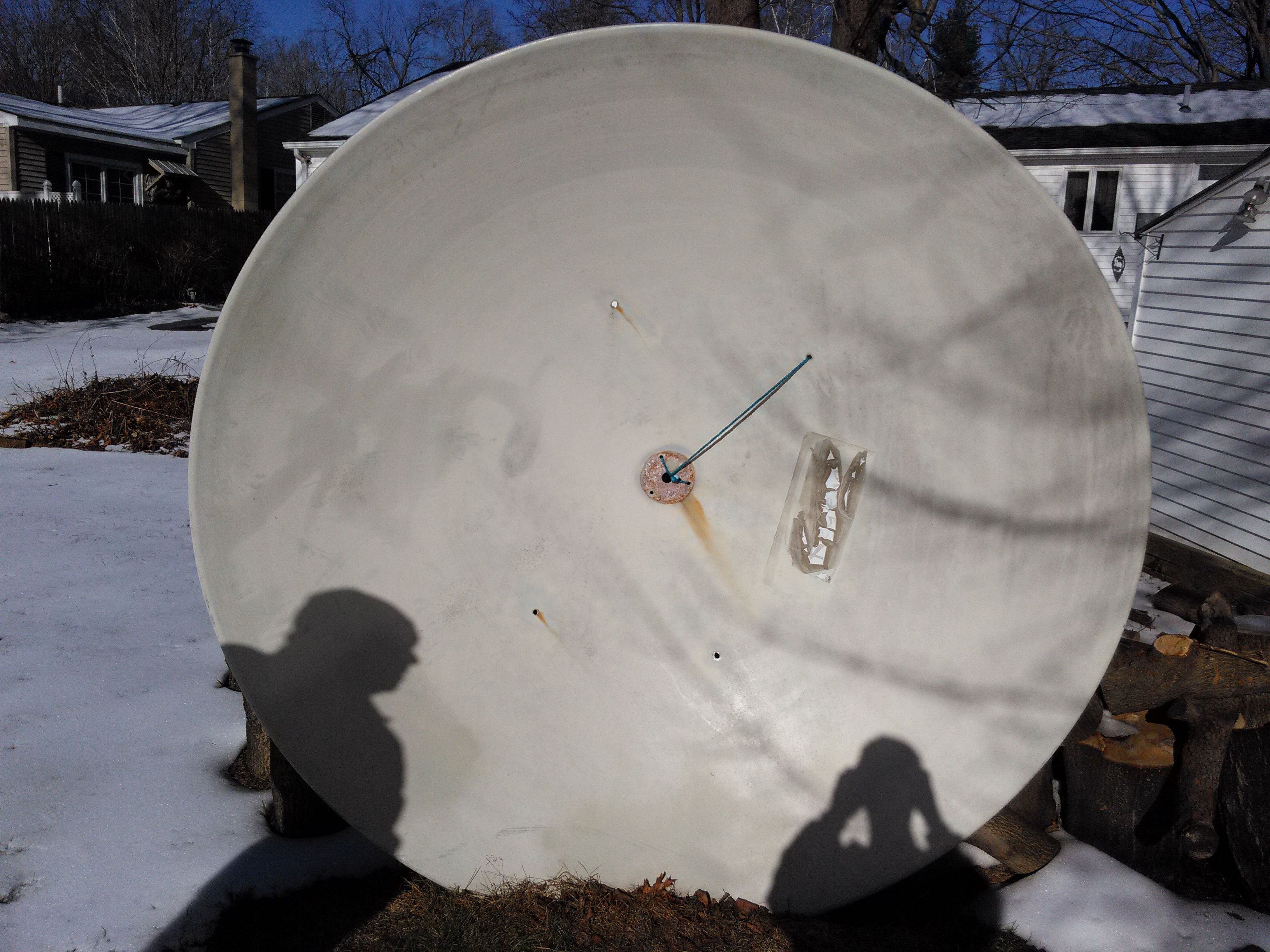

I have access to one of these dishes. It is just the reflector however. There is no mount or buttonhook. Has anyone had any experience with one of these? Does this model have good reception compared to a similar sized mesh dish? I would like to use it for Ku mostly. If anyone has any ideas to make a buttonhook support or has access to any parts please let me know.

It is spun aluminum. Does yours work well with C band?

Have to calculate the F/D, and such, then fab the buttonhook or legs. http://mscir.tripod.com/parabola/ may help .
my buttonhook is held to the face of the dish by sleaving into a short piece of pipe so the focal length and polarity can be adjusted.
I'll try to remember to draw an illustration of that later.
May have to find an orphaned polar mount to graft it to.
If it doesn't have a mount that might be an issue... kind of a make-work project unless you can find one as FaT Air suggests above.
Otherwise as long as the parabolic has not been distorted it will work fine. Support legs would be easy to fabricate using 1/2" galvanized conduit. Bit tricky getting the feed centered so take your time measuring etc.
Was it used as a satellite dish or was it a microwave antenna reflector? The latter might have a longer f/d which is ok, especially if used as a stationary dish with multiple LNBFs, and adjustable scaler type feedhorns might help too. Otherwise regular Ku LNBFs will work well anyway just because of the larger reflector even if a bit more noise seeps in from the sides.
the guy said he was using it for satellite many years ago so I don't think it was for microwave use.
I picked up the dish. If anyone can post pics or links to pics of buttonhook feeds that would be great. I have never seen a buttonhook up close. I was thinking of using copper pipe maybe. I don't really want to convert it to the conventional style right now.
I calculated the f/d ratio to be .28. I am in the process of figuring out how to mount the lnb on it. I would like to try this dish for Ku first.
Since you have to build the mount anyway I would forget about trying to recreate the buttonhook and just use three or four pieces of galvanized electrical conduit or aluminum tubing to make a three or four point support, similar to this:

The advantage to doing it this way is it will be a much more stable mount. The disadvantage is you will have to calculate the length of the rods and more than likely you will get it wrong at first, so I would make them maybe a foot or so longer than you think they should be to start and them measure how far the LNB is to the dish compared to what it should be (this also give you the opportunity to make corrections if the edge of the scaler ring isn't at the same distance from the edge of the dish in all directions. This dish may have already had holes provided for this type of mount but yours probably doesn't, so rather than attaching the rods to the face of the dish I would bring them out to the edge and bend them downward over the edge of the rim so your bolts go sideways through the rim. You will probably have to buy 10 foot sections of conduit anyway so might as well use the extra length to go all the way to the edge. And once you get the LNB pretty close to where to where it should be in terms of distance from the base of the dish, you could make the flattened part that goes over the edge of the dish a couple inches long and make an elongated slot that allows you to slide the rods up and down in order to make fine adjustments, although if you do that I'd use the largest washer you can find (that will fit your bolt) between the bolt head and the flattened part of the rod to keep it from bending outwards. That is the only disadvantage to bending the tab over the edge; if you don't use a thick washer that nearly covers the flattened part it could bow outwards a little over time. Then again, if your aluminum dish doesn't have any rim to speak of, you may have to attach the rods to the face of the dish near the edge, if you want to go this route.

If it were me I'd go with the first approach. If I get a dish that already has a buttonhook mount I will try using it to see if it will get an adequate signal, because I'm too lazy to rebuild something if I don't have to and I was never any good in working with metal anyway, but if I were going to attempt to build a support from scratch I would never try to make a buttonhook support. But that's just me; it's your choice. Hope these help.

the edge of the dish is rolled over. There are 4 holes in the dish for where the mount was. I think I would have to drill holes towards the edge of the dish to put legs on it.
