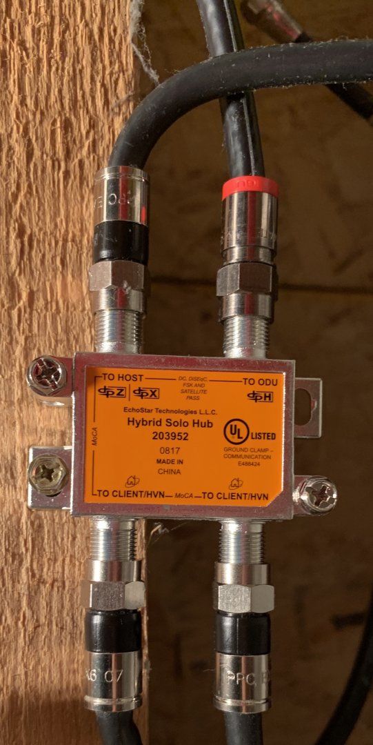

Here’s what I found. RG 6
Reactions: HipKat
You can un-hook the client lines one at a time and see when the Joey you want to move loses audio and video. Then swap that wire with the Host wire and move the Hopper and the Joey and you should be good to go as long as there's no splitters or anything else in the new Hopper line.
