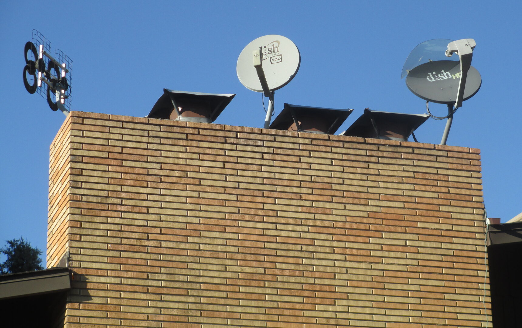

My d¡sh Farm:

My d¡sh Farm:
What's the deal with the shield?
It works great against Klingons . . .
. . . and keeps the Sun out of its eyes. It's really helped with its Tennis Game. If only it was a 1k4, it'd have better coverage of the court.

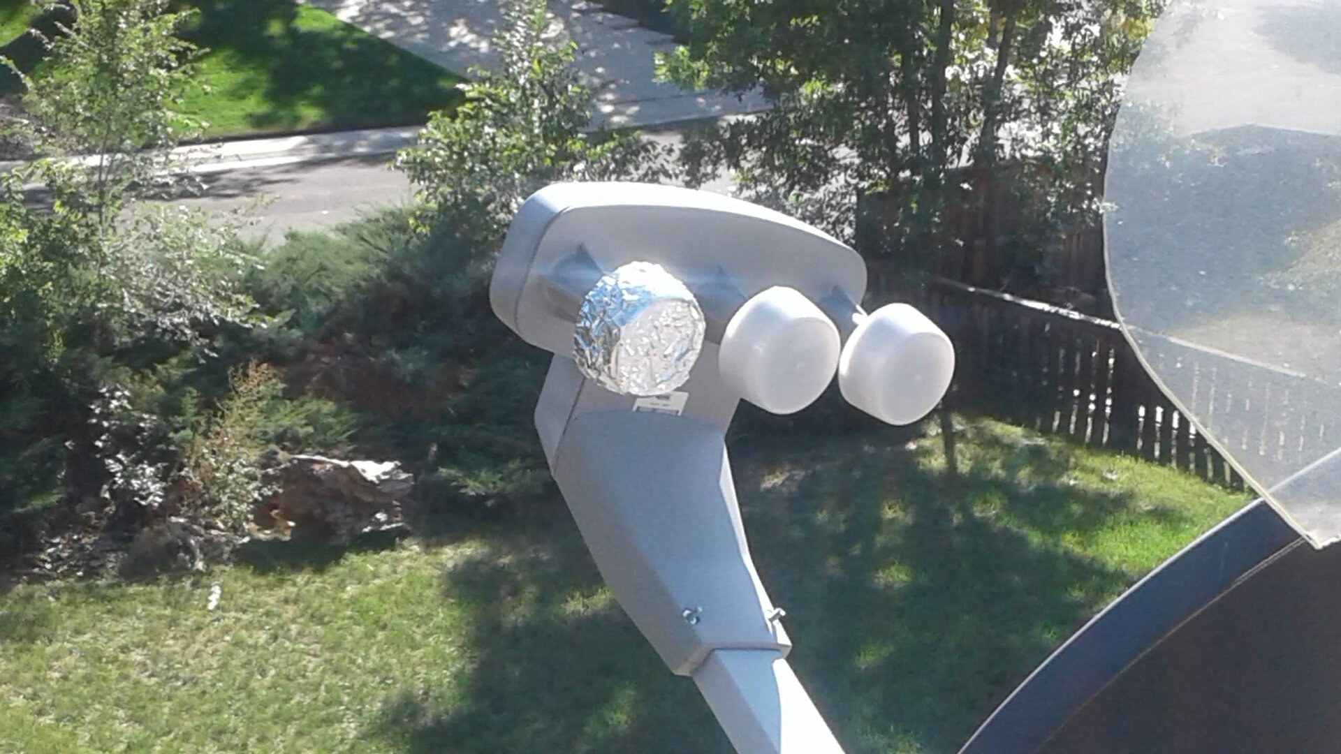

Here's my 129 Horn Condom . . .
Odd setup. Normally with a wind dish you'd just use a D500 rather than need to blank signals on the 129 feed of a 1000.2 so they don't clash. Is the wing connected to the 1000.2's aux input?

Typically the reason that we cover the 129 is if it's getting some signal, it can interfere with the wing dish
Exactly, way back when, I had WA dish but our HD locals were on 61.5 so I had the 110/119/129 setup plus a wing dish on 61.5 and it really confused the Hopper trying to figure out which channels to use for PTAT (It usually recorded only CBS and NBC). Dish finally just gave me an EA setup with 61.5 and 72.7 and solved the mess.
