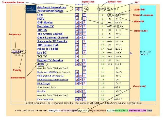

Still a little confused about SR.
For instance G18 for TP24 says the SR is 700. Right above it there is a line with DVB 20000.
Which one to use? Have no idea what the 3.4 for is about.
The SR is 20000, the 710 you see is the Video PID (usually don't have to manually enter that info)
I found this pic somewhere......
Is this a birdview?
