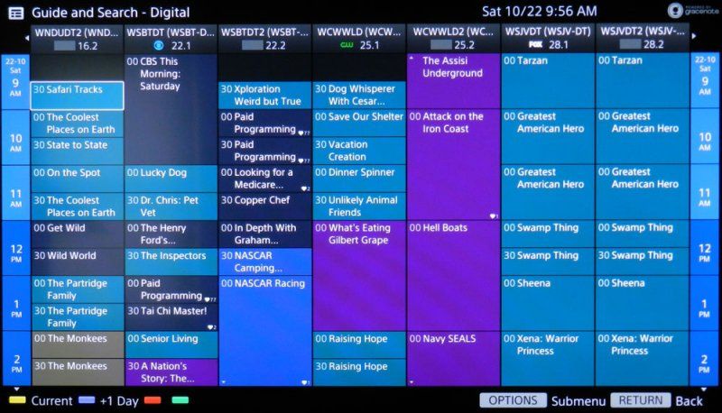

My Sony Bravia uses Gracenote to provide OTA Guide information. It shows the OTA channels and the upcoming programming correctly:

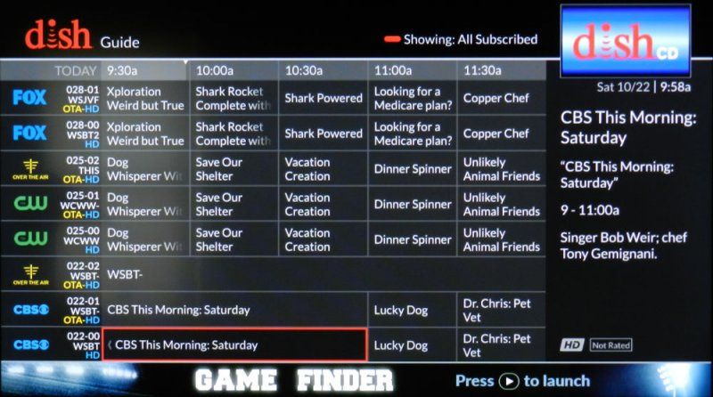

Switching over to my Hopper 3/4K Joey combo, I see this:
Dish has successfully mapped the Fox programming on 022-02 over to the familiar 028-00, renaming it WSBT2, but it then maps that to the OTA channel 028-01. Right now 028-01 is showing "Greatest American Hero" but the Info button tells me this is a Shark Rocket infomercial.
Like I said, I never noticed this until the new Hopper U331 update and I can use the OTA module. Thanks to Timr who first brought this to my attention. Now that I can see it, I can see how annoying this will be until Dish gets the Guide matched up.

Foxbat, what does your Hopper guide display on 028-02? Does it have the correct guide information, no guide at all, or is it also a copy of the incorrect guide information on 028-01?
Until October 1st WSJV 28-01 was Fox 28 (for 20 years) and their subchannel 28-2 was H&I. When Fox moved to 22-2 they replaced 28-01 OTA with a duplicate of 28-2. Both are broadcasting H&I now. Sinclair owns the station and I would think they have plans to change it soon/ add more subchannels maybe.
SBT2 22-2 used to be on DISH in the South Bend market on 30-00, it was the UPN channel years ago but has been independent since. I guess DISH dropped WSJV 28 on October 1st when it stopped being FOX. So it sounds like DISH changed 30-00 to 28-00 in the place of the removed WSJV channel so for DISH subscribers in South Bend they continue to get Fox on the same channel 28-00 and the timers still work. That's what broke my guide since I cannot get 28-00. So now 28-00 on DISH is actually OTA 22-2 and 28-01 is a simulcast from 28-02 H&I.
No real guide data, just the usual 210 hour long event called "WSJVH" (a.k.a. "Digital Service") rated TV-MA. OTA right now, it's "Star Trek: Enterprise" on both 028-01 & 028-02, but EPG for 028-01 says it's "Family Guy" (Stewie and Brian stow away on a flight to Europe, but it looks like they ended up on the Orion Slave colony instead...)
