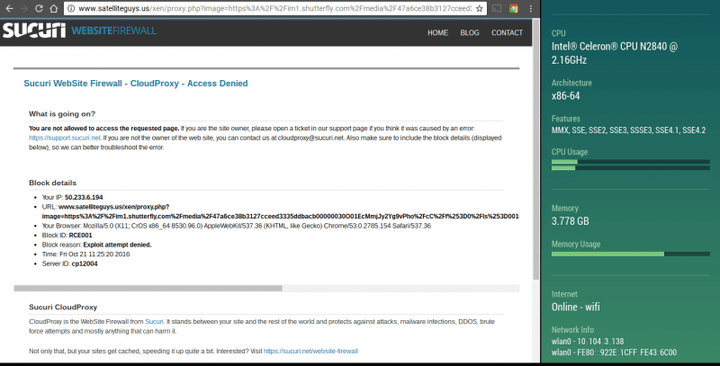

Can you Repost the images? If im not mistaken then I dont think you can "Point Anyware" with only one set of LNB'S
I tried to post another pic from an online host (Shutterfly) and they show up in my post preview but not in the actual post. I am not sure what you mean by "point anywhere." I was pointed to the direction that was provided for a 1000+ dish at my location per dishpointer.com.
