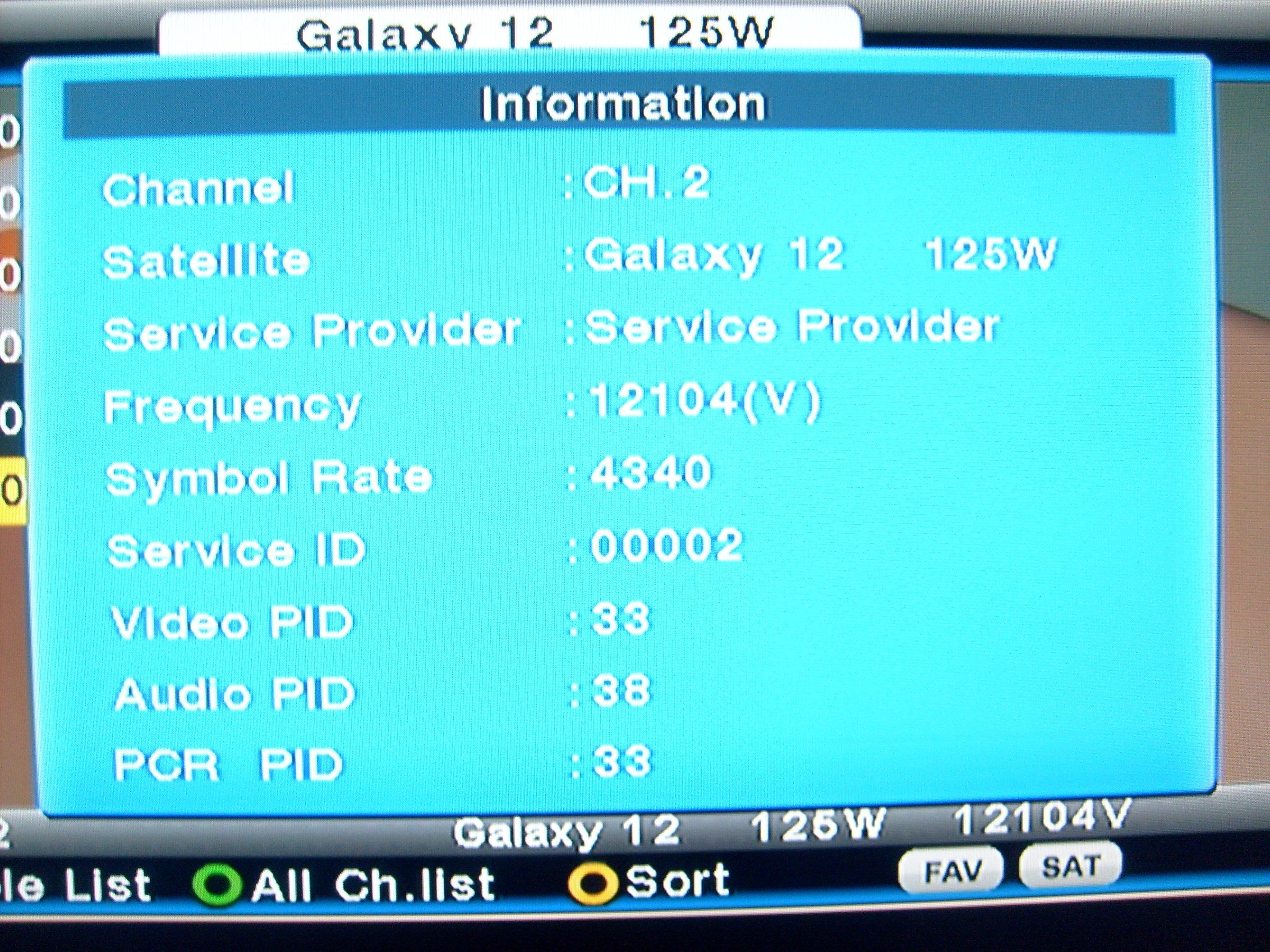

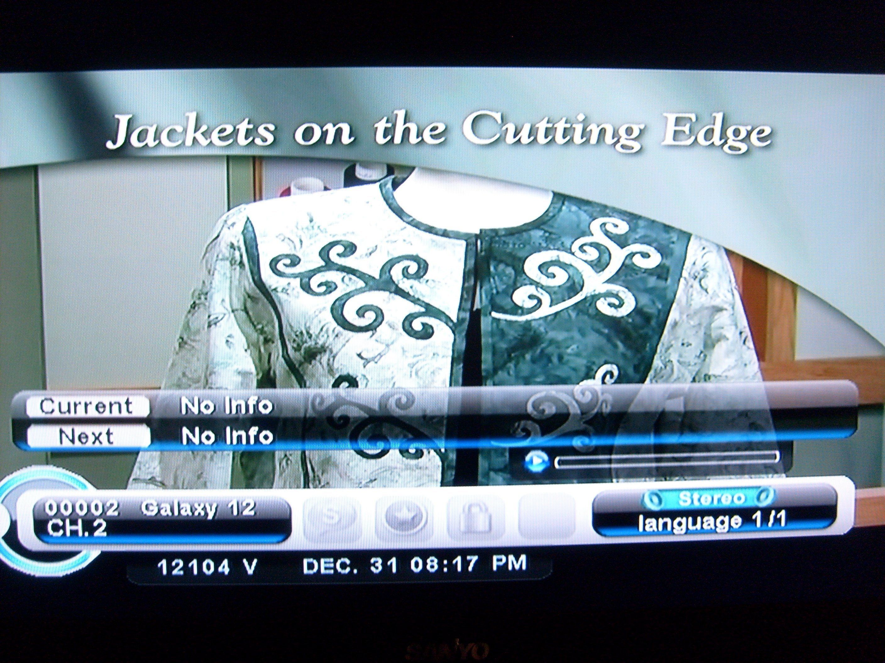

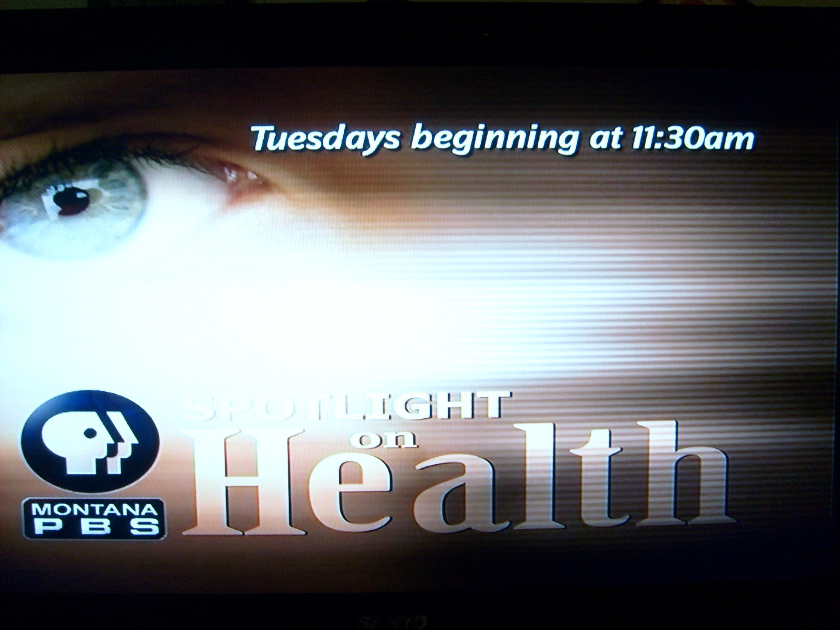

UPDATE 3:32:21 PM EST:
Just entered it in by hand, PBS Montana is still there coming is as CH.2!
So the information above is correct! The first time I scanned the Transponder it did not find it but after the second attempt, if grabbed it! So YES it is still at there!
Watching it now!
Just keep scanning in that Transponder and be patient, it will lock and grab it!
