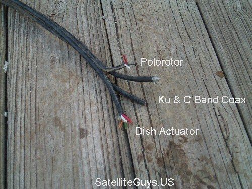

Example of Ribbon Cable

whoa.. mine looks nothing like that. I had a toshiba receiver way back when and it had 4 spring-loaded connectors (like you would find on speakers)
There are 3 wires coming out of the LNB and one that goes to the motor. Each is just stranded wire. I will take a pic of it tonight if it might help.
I found a pic of the toshiba I had, online and there were the 4 spring terminals for the wires.
I dunno, might it be best to re-run the wires? The dish is only about 25' from the house, the 4 conductor still goes in the house and is just coiled up in the ceiling.
