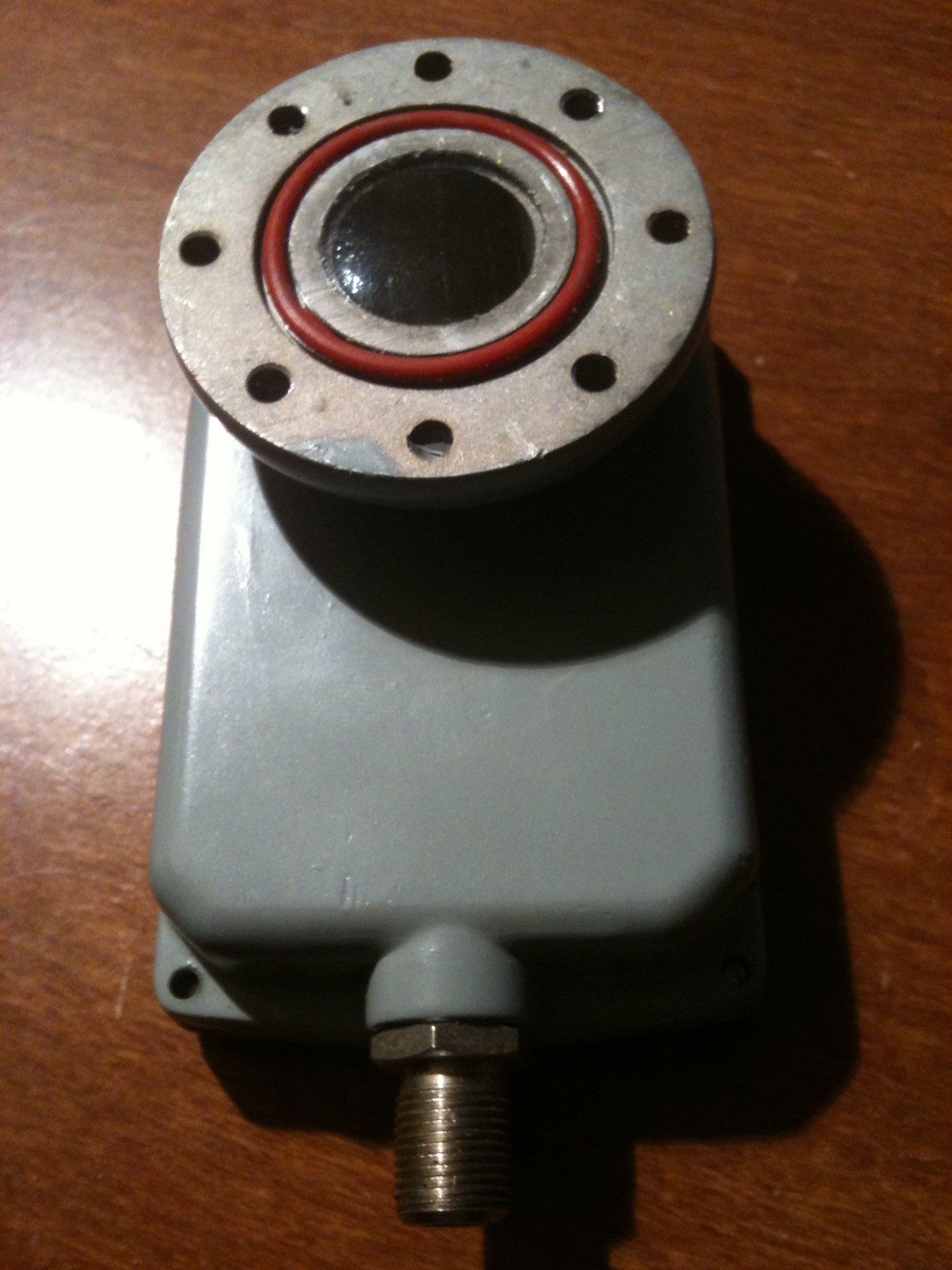

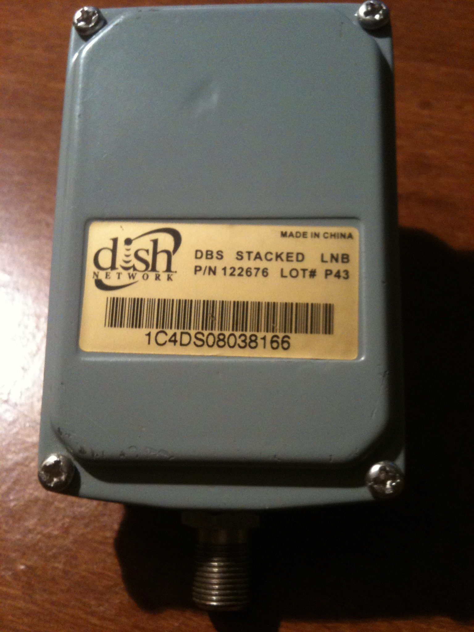

I have a bit of a project that his been on the back burner for awhile and I want to accomplish it before the snow starts to fall, I wanted to take a DBS Stacked LNB use it with a DPP44 and then add it to a 30" Satellite Dish, so I can pick up 129 a little better then my Dish 1000+ can, What I am really looking for are two answers, Can I pickup 129 with the LNBF? (Pretty certain the answer is yes) And the second question is.... Where can I find the proper feedhorn for this LNBF that bolts on, I have hunted down ebay but keep finding ones for FSS and im looking for the proper one for this one that is DBS, the reason I want to use this LNBF is because most dishes larger then 24 don't seem to have the proper mount for a D-Shaped LNBF, I don't want to butcher a DP-Single LNBF and slap it on, I would rather use this one with the proper Feedhorn. Hopefully someone can chime in here,
P.S. I notice a lot of mods for the 121 FSS LNBF but yet none for the DBS to be reused....is this a first perhaps?
I have also attached pictures of the LNBF below:
DBS Stacked LNBF Back DBS Stacked LNBF Front

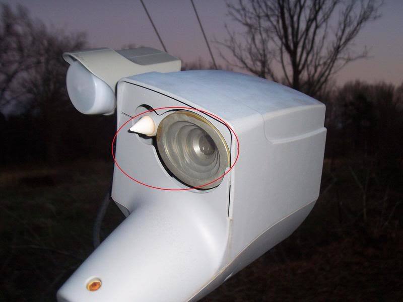

The pencil-point feedhorn (110) from a 105 superdish would probably work for your purpose. I used to have one in the pile, I'll look and see if I can find it.

yes that LNB will work (with a feedhorn attached)

Another idea if someone has it is to find the old version of the 105-110 combo as originally they where separated as I recall, I have also added pictures to perhaps recall someones mind who may have one laying around that they can pass down perhaps?
OLD 119 LNB OLD LNBF OLD LNBF 2

yes, that's the one I was talking about, the pointy one in the middle from the older 105. The newer ones just had a DPP dual without the plastic cover. I have to see if I can find that part for you. It had a flat dielectric plate inserted at a 45 degree angle to accomplish the circular polarity.
There's a thread around here doing a similar mod for a 118 PrimeStar dish with circular polarity somewhere but darned if I can find it now.

Actually you want to do the same thing, get circular polarity with an "aftermarket" feedhorn, this is accomplished with the dielectric plate. You're just doing it with an LNB that gets DBS frequency range rather than "linear Ku" range.
Frequency is determined by the LNB, polarity by the feedhorn.

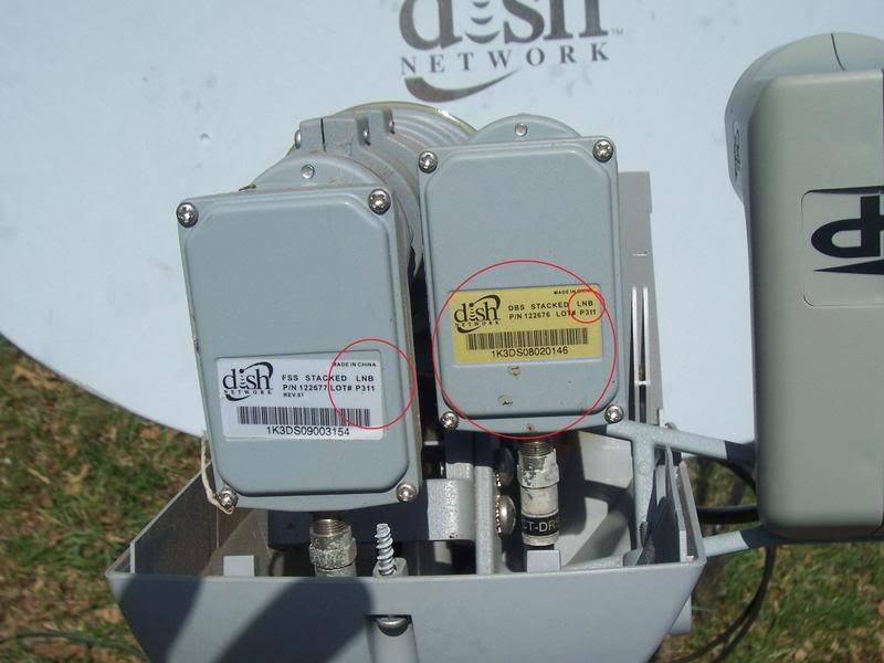

I wish I had access to an LNB like that, The other idea I had was to cut up a DTV LNB, flatten the edge of it with a grinder and then bolt it on, but it would be ideal if the proper feed-horn could be located. Thanks once again for all your replies! much appreciated
If I were doing this, and I do have the parts left over from modding the FSS LNB, I would take the leftover DTV feedhorn I have and not grind out the blade. Just fasten it to the LNB.
http://www.satelliteguys.us/free-air-fta-discussion/253299-dish-dtv-=-fta-dish-fss.html
Anole posted a pic of other feeds he has collected in the thread also
