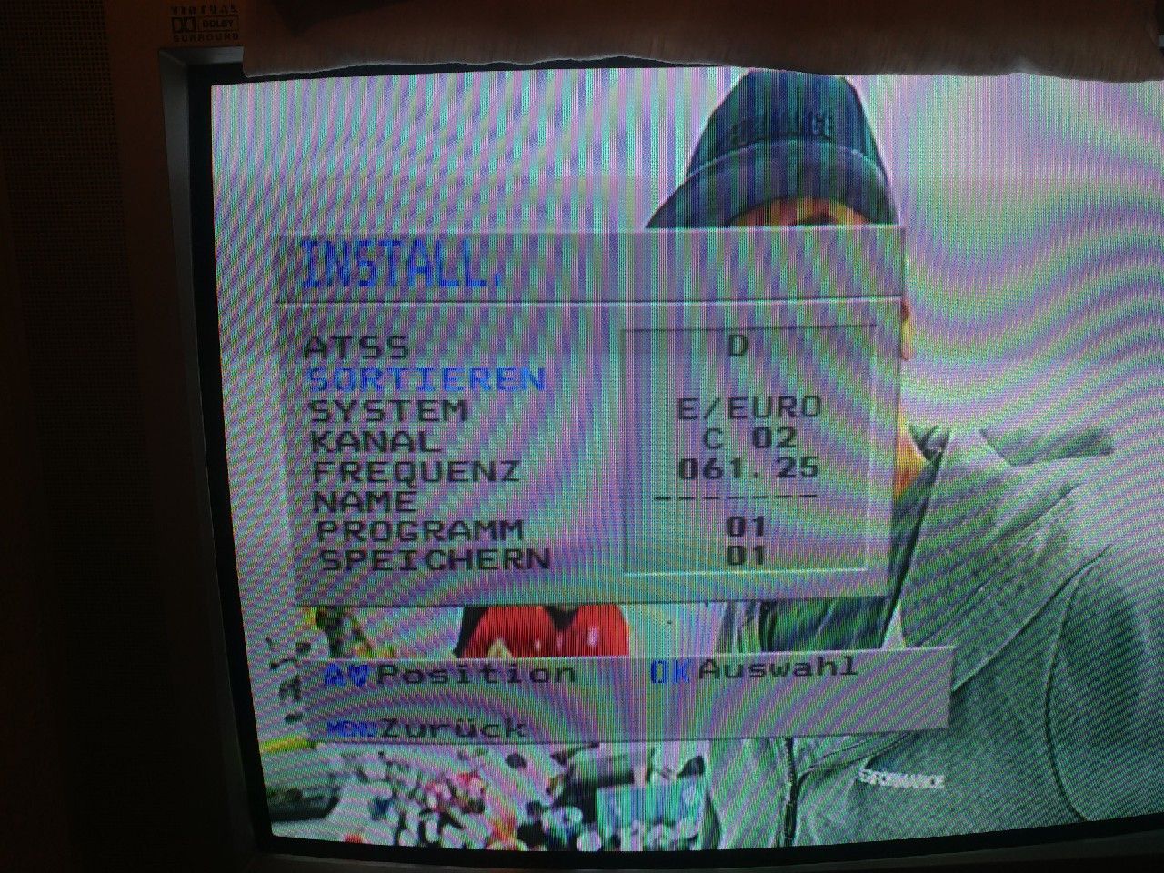

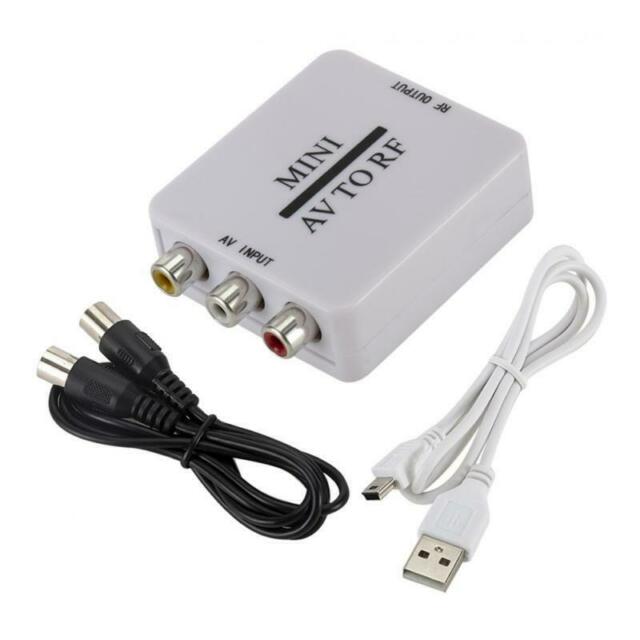

just wanted to say that i solved the problem for no voice on my rf modulator av to rf with mini usb great product for 10 bucks.
had to set the system on E/EURO
there was previously EURO, but simple EURO doesn't work, there is also stuff like GB or FRANCE. GB works good too but FRANCE only sound works, no video.
FYI: this is the youtube app from xbox one S. a television with no hdmi port, but with 2 scart, one AV or RF port and one cinch. it's still working so why replacing it with a flatscreen? one xbox one S, television from a dvb-c-receiver and a ps4 slim. even 2 ports are left.
