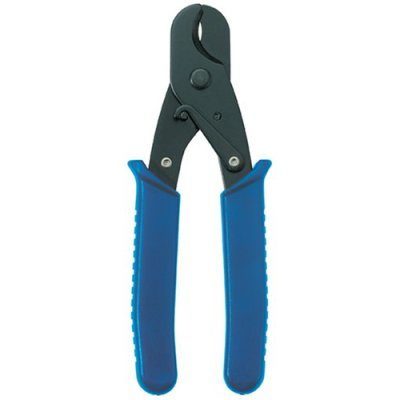

You can easily fix that for less than a buck using side cutters and a twist-on RG-6 connector.

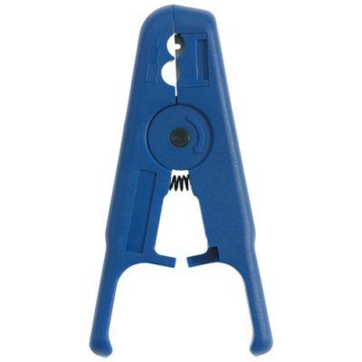

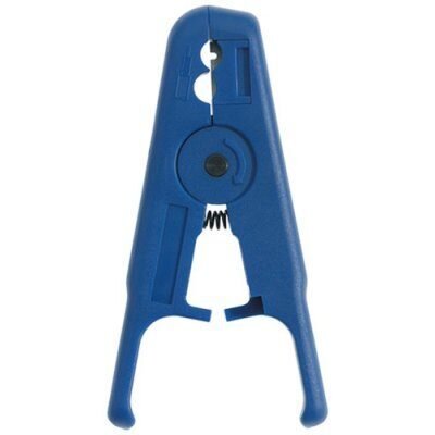

... but about $35 will get you a halfway decent quality stripper/crimper set (the type which makes a hexagonal crimp on the collar of the connector) and a small box connectors.

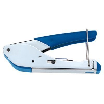

Another option for your F-connectors is the compression-type fittings. These are made by companies such as F-Conn, Digicon, PPC, and Snap N Seal. They provide a 360 degree seal to your shielding, are very weather-resistant (compared with either twist- or crimp-on fittings), and will withstand far more force before coming off. Cable and satellite installers now use these exclusively.
The compression tool for installing these can be had for as little as $15, and is available from Lowes as well as the gold sponsors here.
The compression fittings do look like a more durable solution. If the tools are the same price or less expensive I'd say that's the way to go.
I love compression fittings. There's an expensive compression tool made by Cable Pro that I'm considering purchasing that will do RCA and BNC compression fittings in addition to F. Just a bit reluctant to pay $75-$80 for it...
But the plain 'F' connector tools are very reasonable.
I picked up a compression tool from E-bay for around $20 plus shipping and it works pretty well. The compression fittings are more expensive than the regular crimp ones but in my opinion it's well worth it, they're as close to a water tight connection as you're gonna get.

Here is a popular Paladin installation kit that we sell:
