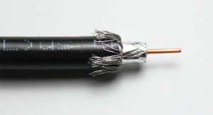

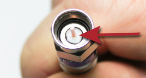

In the image of the original post, the cable preparation is just too sloppy, and this is why your connectors will not push on. Your coax stripper tool needs to make 2 cuts, 1 cutting the outer pvc jacket and the other cutting down to the dilectric (white portion). This portion of the coax (dilectric) pushes into the connector until it is flush with the nut bottom of the connector. So if this is not neat and clean it wont push in. Check out the pics.
The center conductor should be 1/4 in long, the dilectric also should be 1/4 inch long.
To reduce cable insertion force: Evenly flare and separate the braid.
Cable dielectric should be flush with the bottom of the nut.
When done correctly (and with connectors to match the cable type) the connectors should push on and will be a little difficult to push on, but not so difficult you need to bust your fingers.
Hope this helps.
P.S. Make sure not even one strand of the braid touches the center conductor, if this happens you will have no signal whatsoever!
