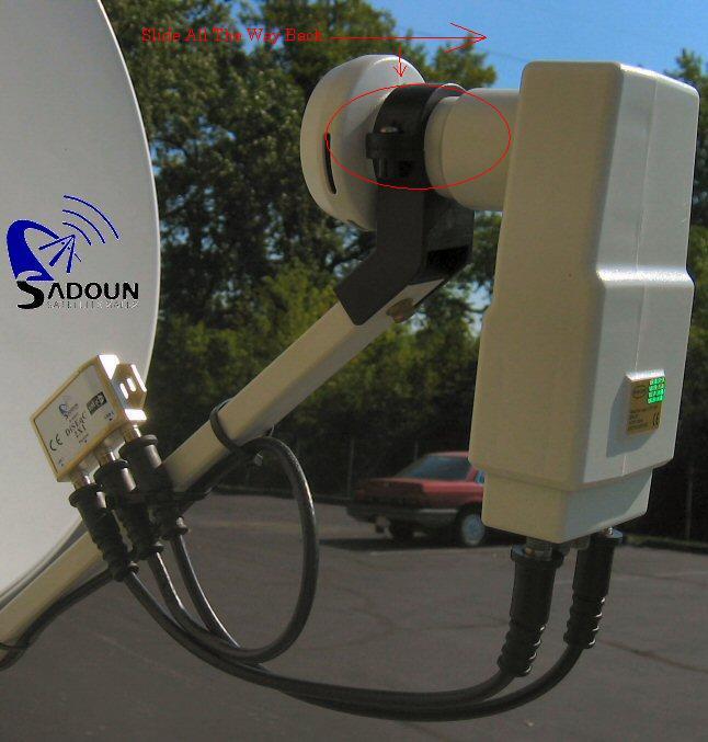

Slide the LNBF as far from the dish as is possible in your holder :up
