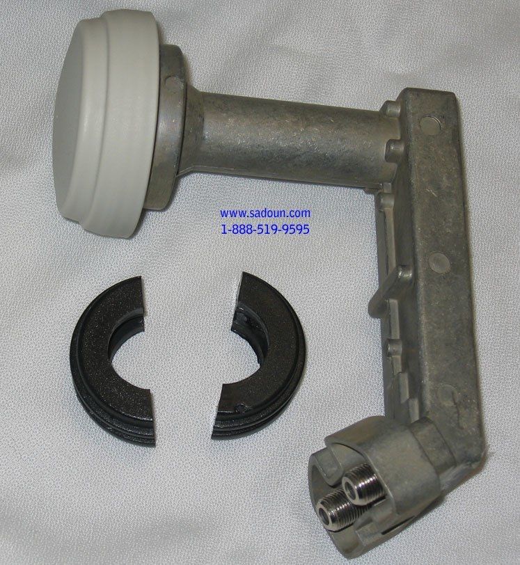

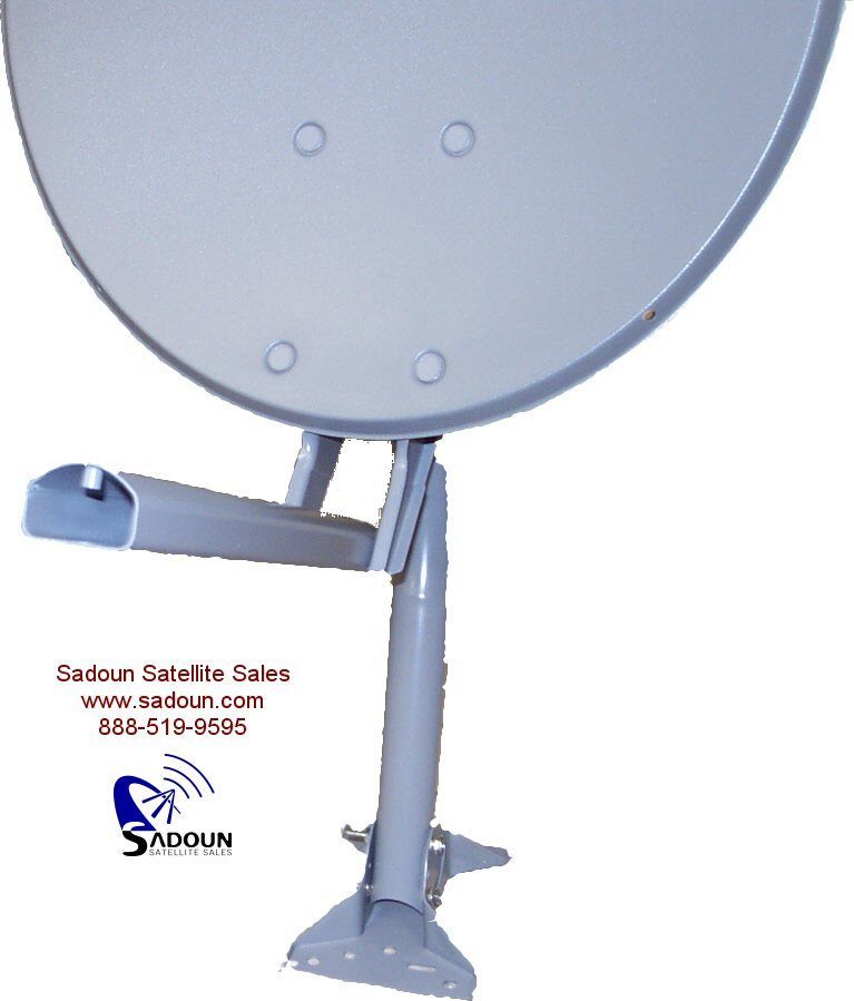

Does it look like this?
A while back, we used to carry SHARP brand LNBF that was standard linear KU with a D shape mounting base just like the picture here.
It was made for Starchoice I think about 6-7 years ago. No longer available.

Exactly...that is it.... Need I buy some accesory to fit linear lnb?
If the dish skews you could plug a square LNBF like the Lava (ROC?) or something right in there. The bit that drops from the top of the D should tighten down on the top of the LNBF. It won't be quite as secure with just the bottom and the bit at the top holding it, but it shouldn't be too bad. You can add a washer or two as a shim if needed.
The conduit hangers are a great option for holding the LNBF by the neck. Leave a Dish Network D shaped LNBF in and lined up and make the conduit hangers fit the neck properly. Then just remove the Dish Network LNBF and clamp a linear in place.
