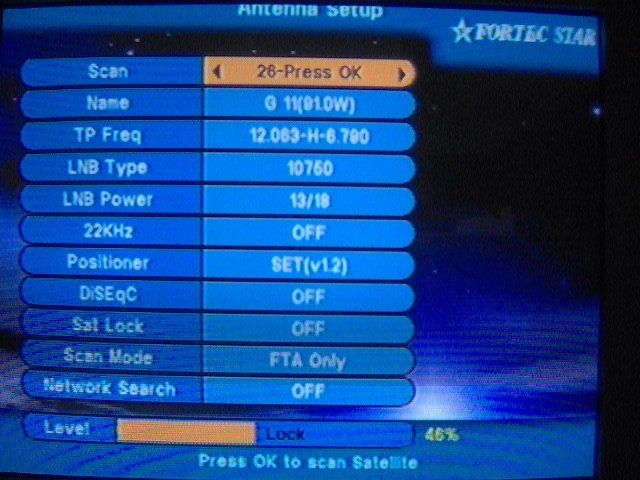

in the setup for each satellite (in the setup menu), you would have to change the "diseqc" spot. I would plug the KU Band (Universal) into port 1 and the DBS in port 2. Make sure to power off the box (switch on back) before adding the switch
here is a screenshot of the menu (found it in the review area). Where is says "Diseqc" is where you change it
