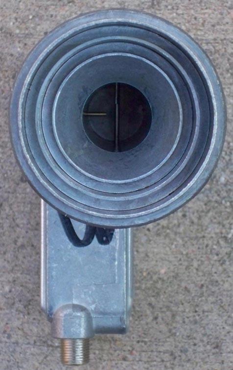

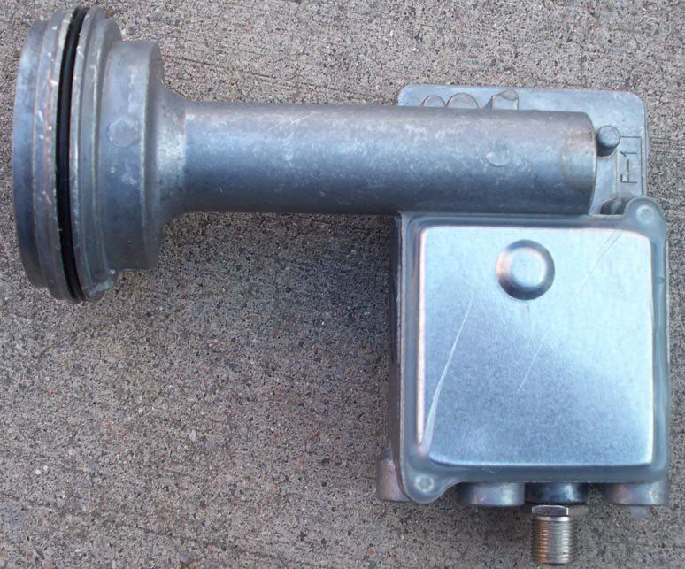

Out-of-the-box the KBSL1 fits the T90 LNBF holders perfectly. But the plastic shell quickly gets in the way for tight spacings on the T90 rail. So I liberated the unit from its shell as a first step (see pictures). While this makes mounting a little more challenging, the diameter of the waveguide is pretty much the same as for the DN FSS feeds, and I already had solutions for those. The shell is not watertight, and in my mind is more of cosmetic than practical use. The feedhorn mouth on the Sadoun unit is larger than the DN 105W feeds, but it is still possible to alternate it with the DN 121W feeds to get two degree spacings.

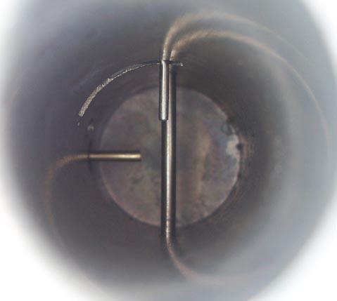

Whoops! What's going on with those V transponders? My friend had first highlighted a similar SQ drop by 20-30 points on these, so mine was not a single bad LNBF. Off popped the LNBF feed cover to reveal what is likely going on. In the picture of the feedhorn mouth, one can see the probes, but it's a little hard to note the relations between them. I scratched my head to figure out a better way of showing this, and was able to get my camera to get an odd but useful photo. The H probe is near the back of the waveguide, which is normally the best place to put a probe. But it can be tough to squeeze in probes for both polarities, so the designers for the Sadoun LNBF chose to move the vertical probe forward, and put a vertical post behind it to simulate a back plate. I've seen other cases like this and this design compromises the performance of the forward probe. I'm pretty sure this is one if not the main reason why the V performance falls at the highest Ku frequencies.
What bothers me in particular is where the spectrums fall. The KBSL1 has LOs of 10750 for H and 10100 for V. That means 11700-12200 MHz runs from 950-1450 MHz for H and 1600-2100 for V. This puts the poorest performance of the V polarization at the very top of the L-band spectrum coming down the cable to your receiver. This is where one would expect the most signal degradation, and the degradations will combine.
By comparison Dish used LOs of 10750 for V and 13850 for H. The means 11700-12200 MHz runs from 950-1450 MHz for V and 2150-1650 for H (note inverted spectrum). The DN LNBs have PCB probes at the same optimal distance from the waveguide and do not show a similar degradation. But any stressful performance problems at the top of the H range are passed mid-L-band where distribution systems are likely to be benign. This choice would have helped the KBSL1, and another alternative would be to switch the LOs so the more stressed polarization came down the cable at 950-1450 MHz instead of 1600-2100 MHz.
After painting the picture a little on the gloomy side, it is important to note some mitigating information. First I suspect the DVB World 2104 tuners provide very misleading SQ measurements at the top of L-band, particularly when the noise floor is not flat across the spectrum. I was surprised to discover this a couple of months ago chasing down an unrelated problem. Both my friend and I see similar drops in SQ for the top V transponders when using the 2104s. But look at the Pro 7301 numbers: the SQ goes down from 100% to a still respectable 90% and only for the highest frequency V transponder.
This is largely confirmed by actual demodulation performance. Normally my 2104s start losing lock when the SQ falls a few points below 40%. This is when the noise floor is flat, or I'm only using the lower 500 MHz on the cable. But at a 34% SQ, the DVB World was locking perfectly and wasn't even close to losing lock (I did a quick test). The Prof 7301 normally loses lock for me just below 20%. It was coasting here at 90%. This makes me fairly certain that the 2104 uses a SQ algorithm that yields meaningless numbers with a high-end rolloff in L-band. The 7301 is more reliable.
The reduction in performance on the high V transponders is real. The 2104 exaggerates it, but it is measurable on the 7301. But both units still receive fine under these conditions. While it would be nice to see this improved, overall the KBSL1 is a definite winner in performance over the bandstacked DN units.

If this is a brief review, I'm going to love a complete one! Your autopsy photo's illustrate the probe positions very well, excellent detective work in finding the weak spot in the lnb. Hopefully Sadoun's next revision will swap the H & V LO's on this model to compensate.
