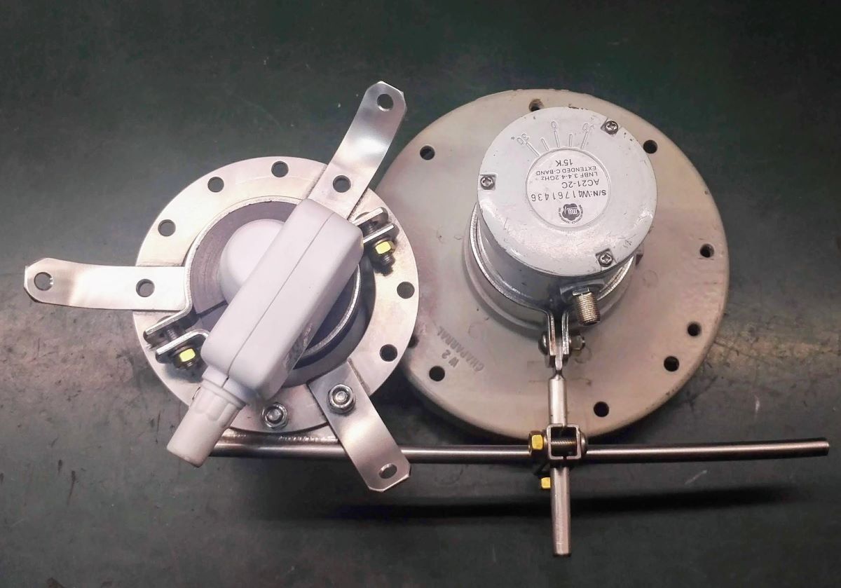

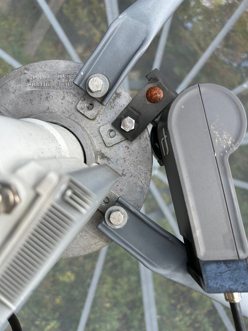

I used the platic part of a generic Ku LNBF holder, and a piece of flat, stiff ABS plastic, bolted to an unused hole in the scalar (since it has holes for 3- or 4-arm setups)
on the left is the Titanium C2-PLL, and for Ku I used a twin Inverto Black Premium.
I'm in the process of building a new one, that I will 3D-print, as the current one is a bit broken (those Ku LNBF holders get very brittle after a few years)
The most important part to remember is that the Ku LNBF must be located in the same plane as the C-Band feed (plane that is perpendicular to the polar axis, minus the declination) so that is also points at the arc. Of course the Ku satellite positions are shifted compared to C-Bnad, by about 6-8 degrees.

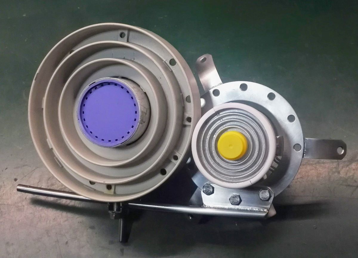

I like universal solutions, like on the pictures. It is possible to install C or Ku band LNB in the focus. It is also possible to move scalar closer/further from the dish and to adjust multifeeded LNB fully independently.
But, of course, any solution is good when it helps to achieve needed results.
