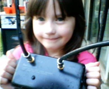

To fix OTA channels , welll i guess I have asked too much of voom. I have 3 STB's from Voom. and I and 2 install companys have not been able to get my OTA channels to work on all 3 stb's, having the OTA signal going throgh 1-multiswitch and 3 diplexers caused to much bleed off of signal even with my 26db amp. So i had Advanced satilite (A+outfit) run a cable direct from My BIG OTA antenn (supplied by VOOM)(helped by a 26db radioshackamp) to the back of my Liv room Motorola STB, bypassing multiswitch and diplexers. and wallah, all channels antennaweb said i should get, NBC, CBS 2 channels,PBS 2 channels, ABC, FOX, WB farthest from me at 33 miles is lil fuzzy but. ok and spanish networks KWEX 2-channels, KVDA.

(all inside wiring and connections were reun by me before they arrived to speed install) so they ran the new seperate ota (split off my big ass OTA antenna) cable to my bedroom bypassing that F%@&ing Multi-switch . and once the diplexor was removed from the back of the box, I had all my OTA channels on my bedrrom tv too, YEAH !!!!!!.... They also installed my new 24 inch DISH which gave me a 97, and its cloudy out, i didnt get that high of a signal on a sunny day with that 18"" dish. and they used a meter to get me the stongest signal(first installer out of 6 Visits to break out a meter). after they completed finish work and omg,, grounding my dish. We saw improved PQ on all my HD and now i have all locals. These guys knew what they were doing. I will post this companies info under the who did your install thread.

im using a RCA3030 antenna and a 26db radio shack amp no diplexors. seperate cable run.
