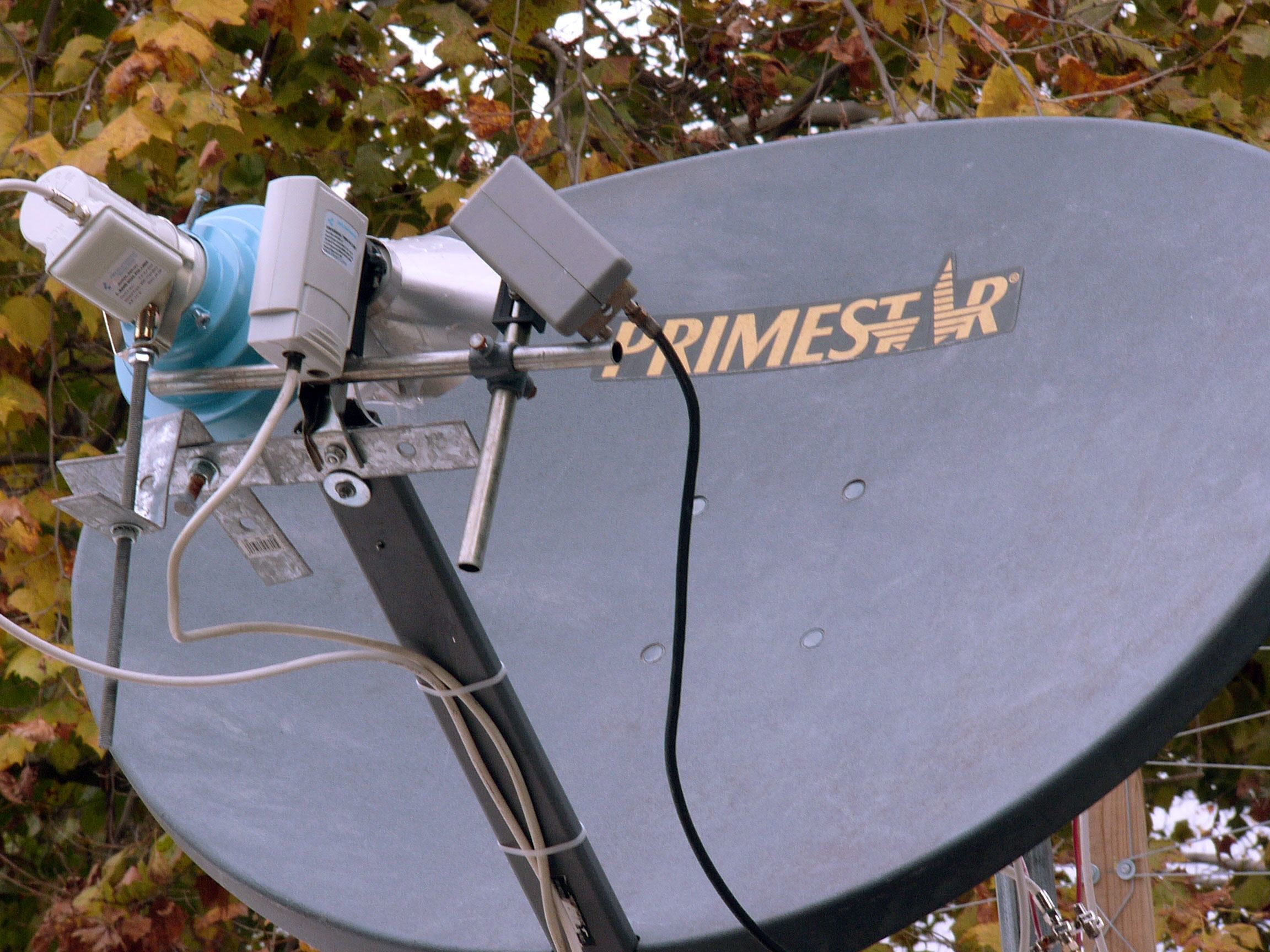

BTW More problems with DiSEqC today... I'm in the process of setting up dummy USAL sat locations for my Cband and Circular LNBs, which are 10º off center in either direction. (see pic)
The thing I like on my CNX is that it allows you to edit Sat locations after the fact. So if Using USALS if 91º would gain a couple of Q points at 91.1º, you simply type that in instead of using DiSEqC. I have a couple of sats that benefit from a slight tweak.
I'm cool with the dummy sat set up. The problem I am seeing is that I will soon (hopefully) be using DiSEqC to control a GBOX and my problems will return.
