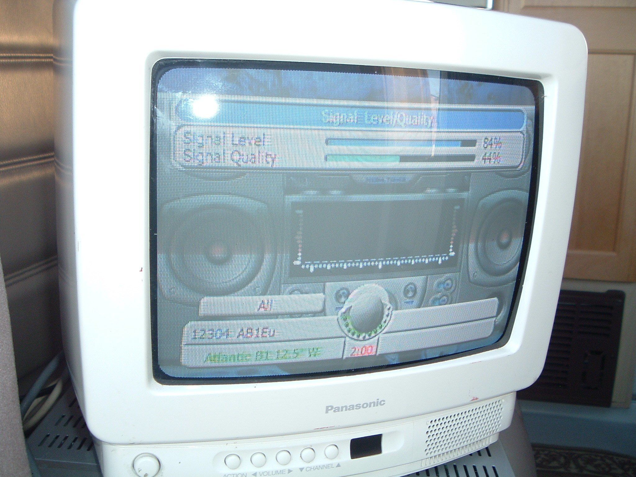

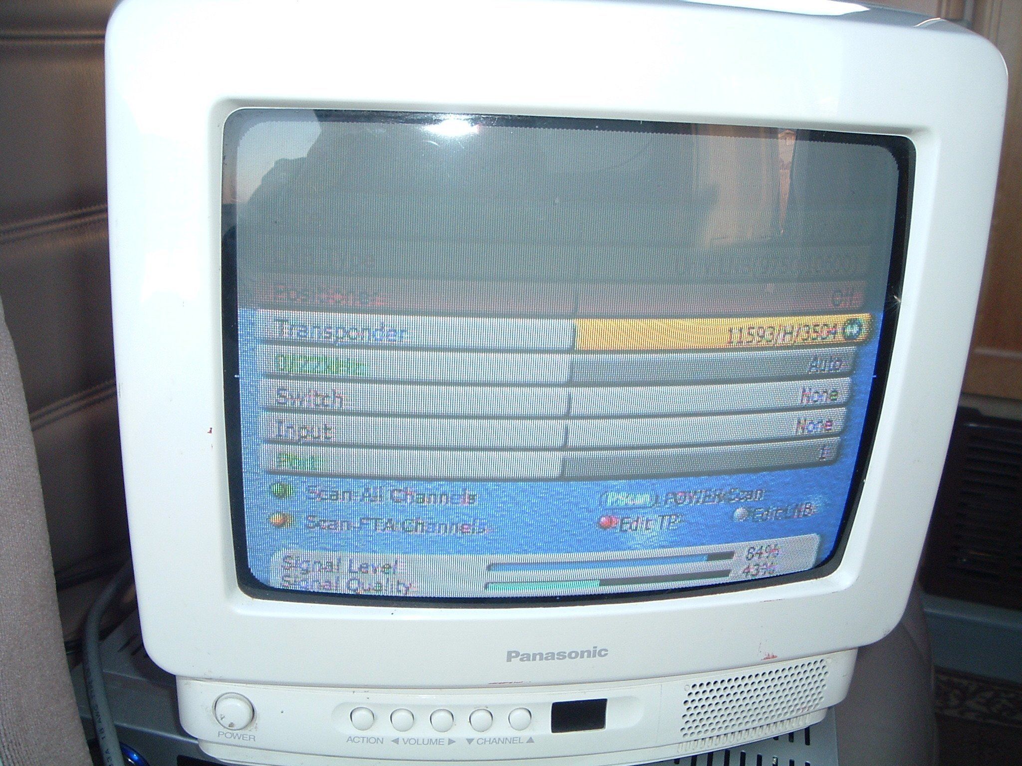

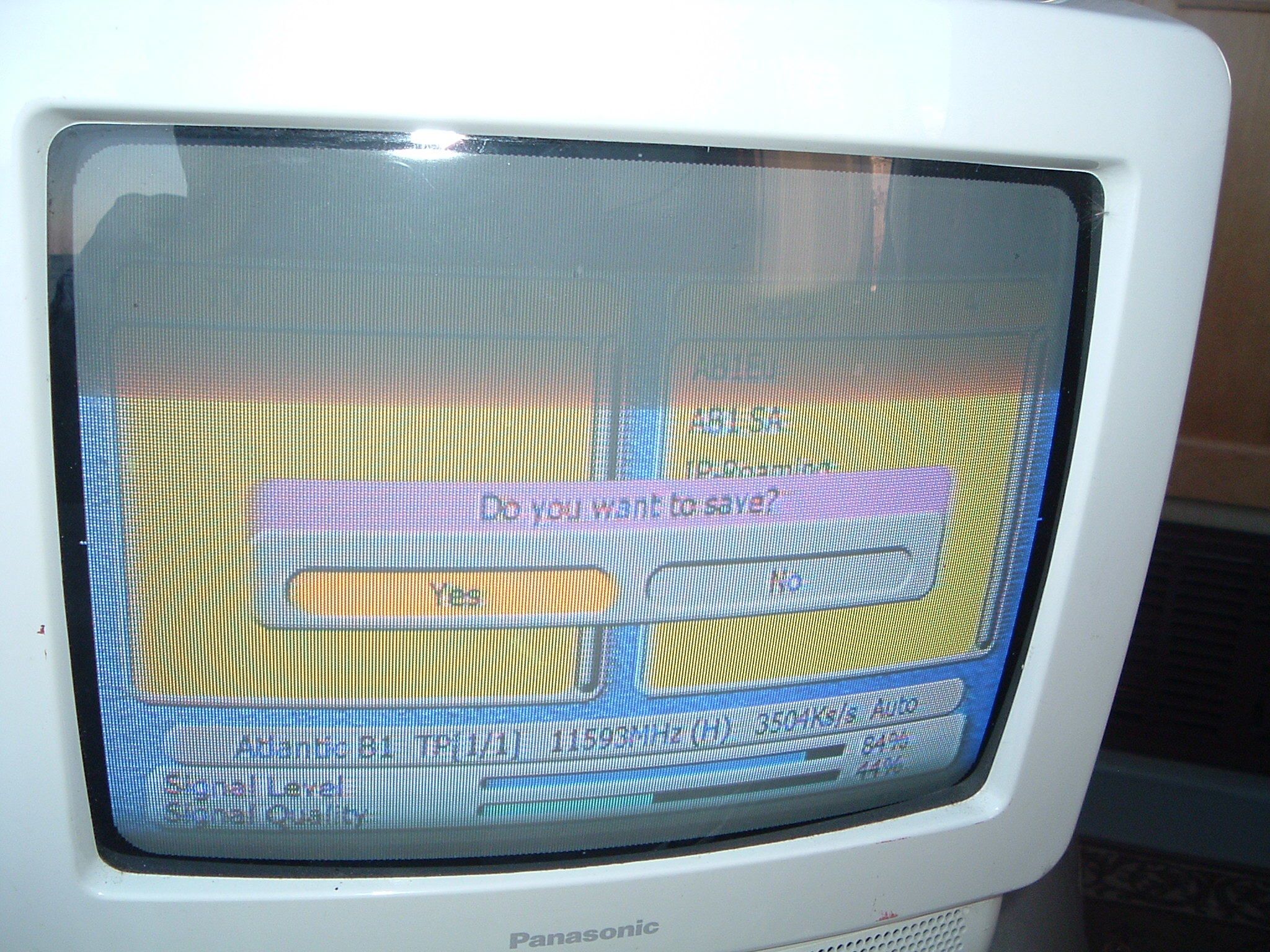

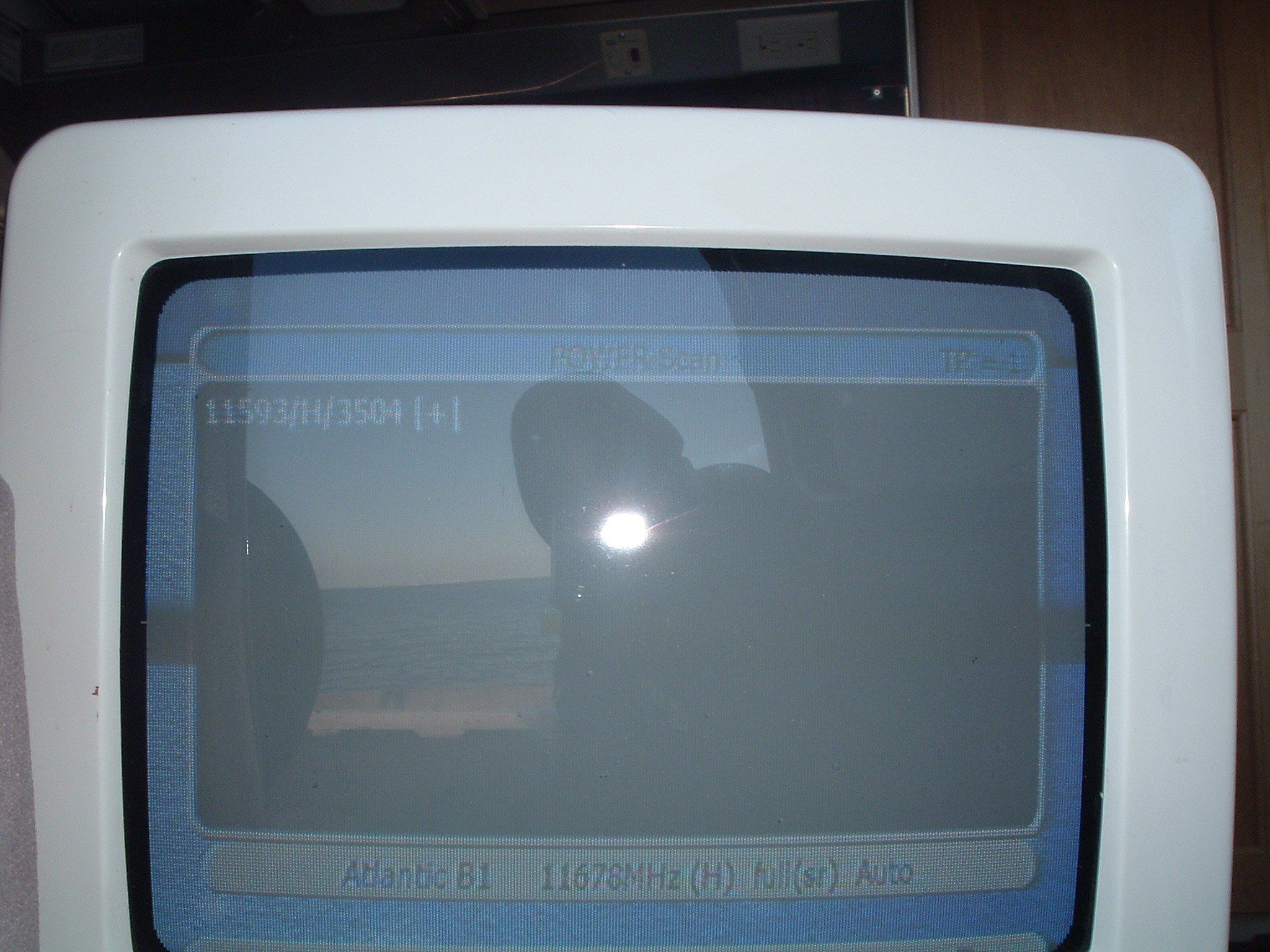

Last week before the North East'er rip through New Jersey, I went down to the bay to try and find Atlantic Bird 1 at 12.5º West. I found 30º West with no problem (nice salsa music and salsa dance contest on Cuba Vision.) I slide the dish over, and at the azimuth for Atlantic Bird 1, I did a blind scan and came up with a strong transponder that was id as Skylogic, a satellite Internet provider. The transponder was 11593/H/3504 and it scanned in 4 radio stations that had no audio. They were, AB1eu, AB1sa, IP-Roaming and PCR.
I could not find out any info at Lyngsat, or Skylogic's website.
Has anyone ever seen an Internet transponder with a low symbol rate that scanned in as radio channels with labels?

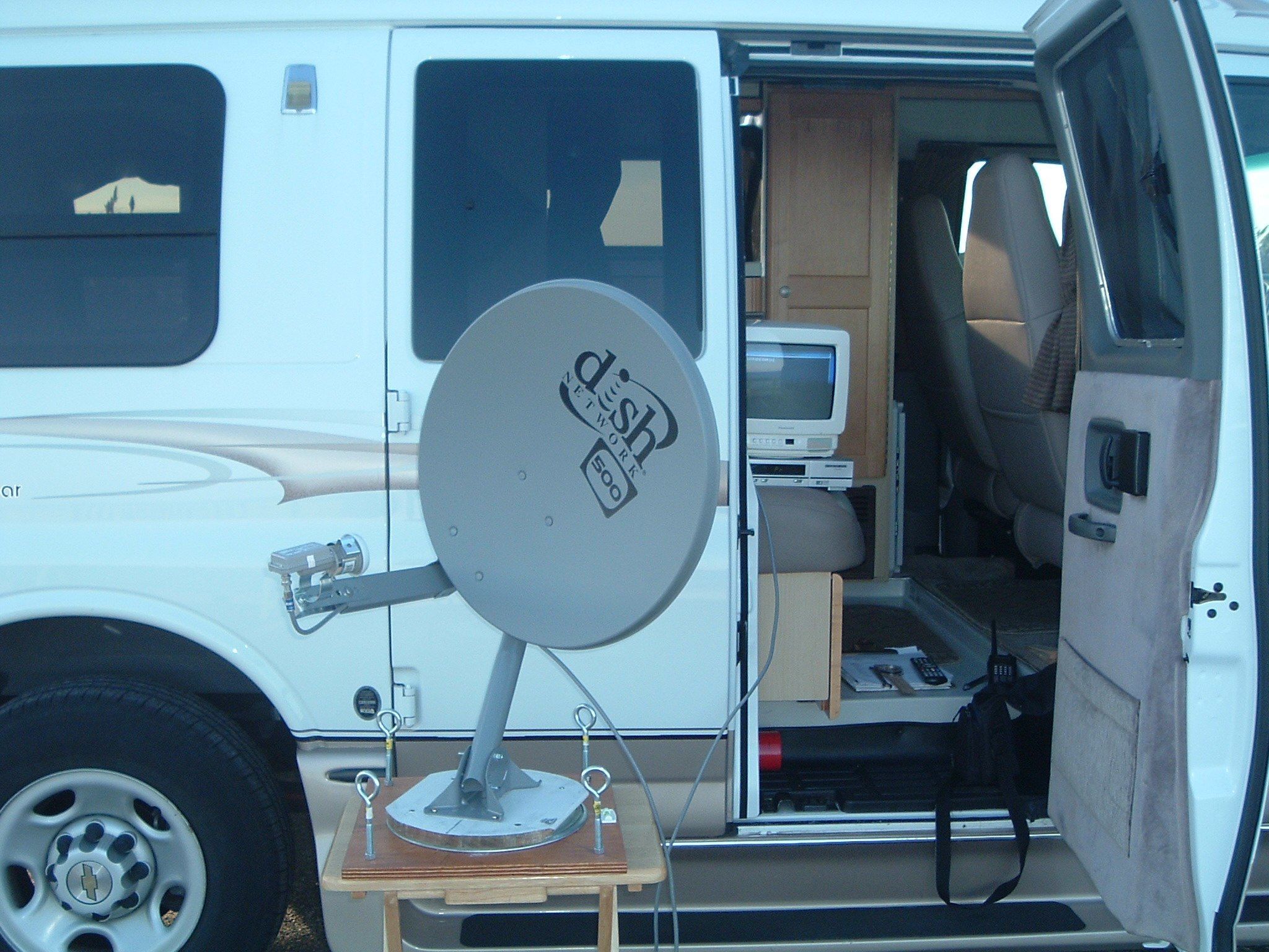

The pictures of the find are attached; receiver is Fortec Dynamic, 500 Dish with a Universal Chaparral LNB.

By the way, nice van, can I have it? :)

The Van was a retirement present to me, I was going to use it travel a lot, but it gets limited use. I use it to go and see the kids and grandkids down in Charlotte, NC.
I have a 2004 model on a 2003 Chevy 250 Express Chassis check it out:
http://www.roadtrek.com/models.aspx?ModelID=12&YearID=11&Country=USA

If the signal is MPEG4 most receivers (that handle MPEG2 only) will log those channels as radio
Iceberg: Tnx for the info, I do know that the transponder was ID as Sky logic and they do use Atlantic Bird 1 & 2 for satellite Internet service. If I was locked on to the correct satellite I should of received the North America spot beam that is listed in Lyngsat one of these days I am going to invest in a spectrum analyzer.
