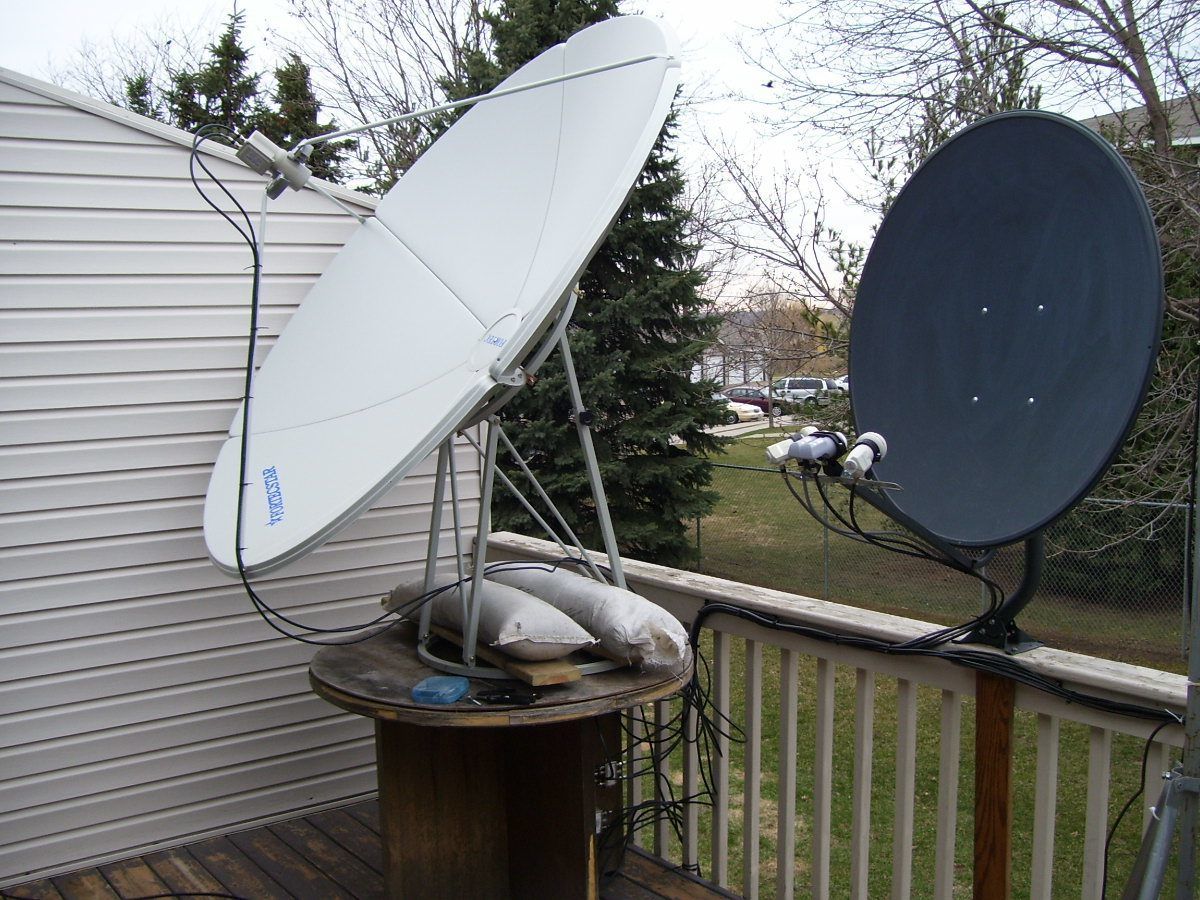

Good example of a offset dish.....this is a pic of part of my dish farm. The big dish at the end is aimed at 38 degrees. C-Band dishes are prime focus so the look angle is true...38 degrees
The grey dish next to it is ALSO aimed at 38 degrees but since its offset it looks like the dish is up and down
