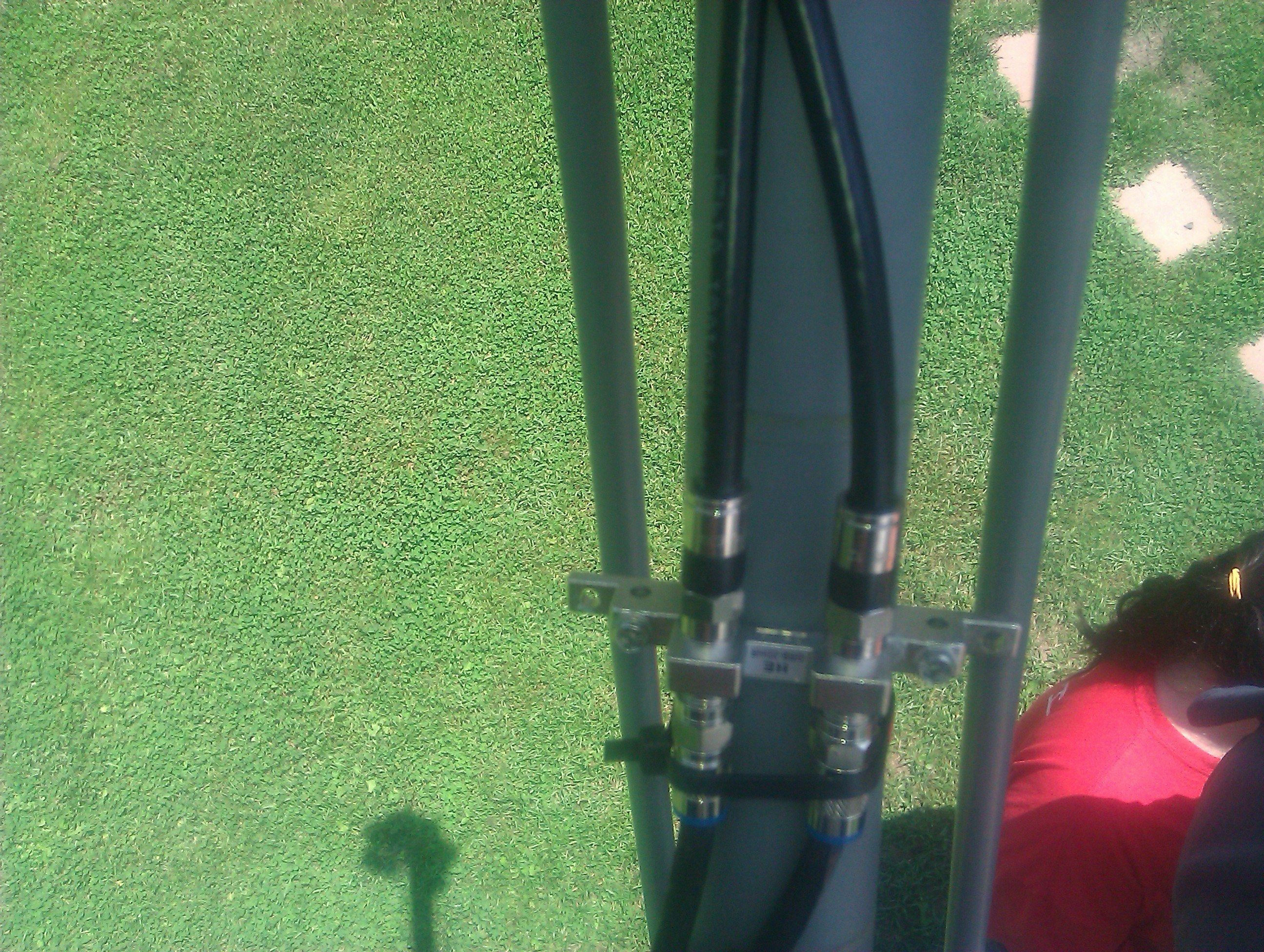

Here is a pic of what it is, the top 2 lines are coming from the lnb, the bottom 2 are going into the house. IMAG0319.jpg

what you are seeing is actually two cables all the way through. those things in the middle just pass the signal from the top straight through to the bottom. not sideways or angleways.
you could get away with a grounding block that only had one position on it. the one in the picture has two. (looks like they forget to run the ground wire to it, oops!)

That would be a ground block. Thing that concerns me is that I see no ground wire attached anywhere.
