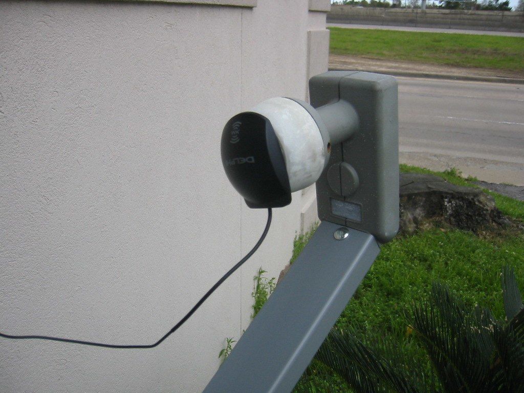

Here is a graphic of both Sirius & XM sats & coverage maps. You can also use a sat. dish to increase the signal strength for XM's fixed sats. the 4th pic is such a setup from Costa Rica receiving XM, you need to aim the dish at XM's sats for this to work

Interesting pic for the Costa Rica dish. It's not the optimum focal point but I guess if it gets the signal then it is good enough.
