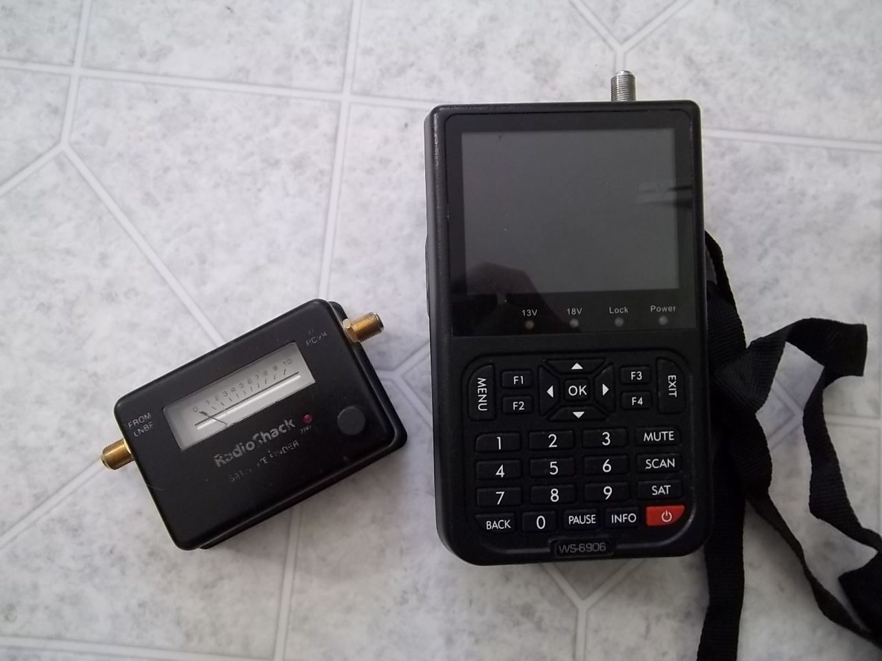

I had a WS-6906 for years, the earlier version, but the rechargeable battery finally died and could not find a replacement. It was a pretty good meter but did not have USALS and would receive only MPEG-2. If I remember the satellite calculator was a bit off, but it did a nice blind scan, and had a lock LED when you found a hot TP. There were no subsequent software updates even though it had a port for updating. The instructions that came with it were minimal and you were pretty much on your own as to figuring out how to use it. It came pre-programmed with most of the C and Ku band sats, and editing/deleting/adding satellites was pretty easy.
The volume control on the WS-6906 was adjustable, it just took a little figuring out. You had to be receiving an FTA program on the screen, then you pressed the left and right arrow buttons where the "OK" button was for increasing/decreasing the volume.
One weird thing is the meter had a male F connection, so you had to screw in a female to female F adapter to connect RG/6 cable.
I did a review of the WS-6906 sometime in 2011 in Monitoring Times magazine. They are still available, mine cost originally $243 (ouch!) but some are going for less than a hundred bucks now. Satlink has blossomed out with many different models these days, they seem to have a lot more available than years ago.

The reversed F-fitting is a great feature. Simply screw in a new barrel fitting when the cinches wear out and quit making good contact. Much more user friendly than disassembling the meter to replace chassis mounted connections.
