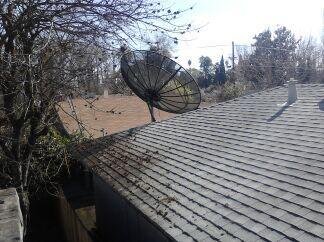

this guy answered my criagslist ad.he says he is moving and is going to get rid of the dish.i asked how much do u want for it and he replied how much will u give me.he says i would have to take it down myself.should i just say $10 or something? hehe :P
If that is an over-the-roof very tall pole and dish, you should tell him to pay YOU to take it down! It'll take some work to do so, you'll need friends, and he should compensate you for it and still give you the dish (for a discount, you tell him).
I can't recommend an over-the-roof dish for your first time.
I've collected two ground-mounted dishes, and still wouldn't do it.
And yes, it's a pretty dish.
The chance of hurting yourself, the dish, or the house are just too great.
Of course, if your Dad owns a crane company,... ;)

Well he said he's too old to take it down for $20.I told him him the only thing I can offer him is a sewing machine if I take it down.seems like he didn't like the deal.no answer from him yet.will be checking a 10ft one from a nearby town on sat.

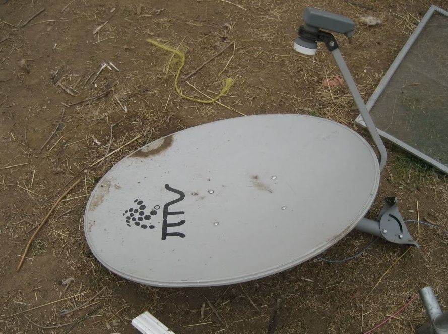

well i picked this up from a yard sale.you guys think i can set it on a pole and start aiming(97 w) with the microhd unit or do i need a signal meter?

Might be the photo, but the reflector looks bent. Stretch two strings edge to edge at opposite angles at several locations around the rim. Do the strings lightly touch in the center of the dish where they cross? I believe that the dish is warped and might need correction before any aiming.
No, you don't need a meter. Select the satellite that you are aiming for and activate in the satellite list. Set the LNB LO setting to match the LNBF LO frequency. Select an active transponder for this satellite and set a small TV next to the dish so you are able to watch the meter for the Signal Quality reading to indicate when the dish is on the satellite.
you guys think i can set it on a pole and start aiming(97 w) with the microhd ... ?
How big IS it?
What kind of LNBF does it have?
Looks suspicious (very non-standard), so I make no assumptions.
