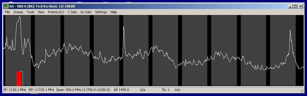

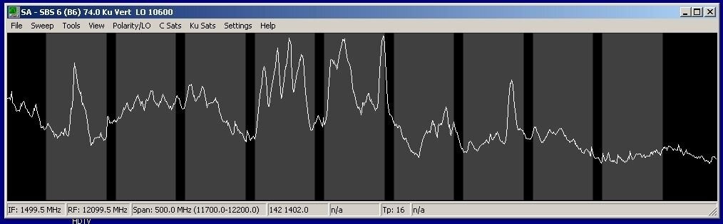

The Broadlogic Spectrum Analyzer is not a true spectrum analyzer, but rather a Broadlogic DVB-S PCI Card modified to act like a spectrum analyzer. As such, it doesn't have a numerical C/N readout. Attached are two scans from SBS6 earlier today. I have no problem with horizontal signals, but I have a hard time with the vertical signals. http://www.moonglow.net/tvro/blsa.html
Your Vert sig levels are the same or better than Horz. Can't understand why you are haveing issues with that pole. The only thing noted or that I can see is a few notches in the spectrum..That is kinda common with L-band and cable/connectors but I don't seem much attenuation there. I would not say you have a recieve problem from ant to the PCI card...From there on forward I would start to troubleshoot. Since you have a quazi spec ann, sweep you cables and look for annomolies/notches/atten spikes...L-band is a bitch to clean up...Question, why does you spec ann info inidicate 10600-LO?
Forgot to add....X-pol looks good as well...no substantial bleed over...
