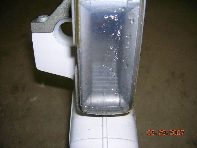

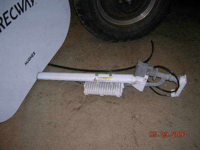

Here is the lnbf assembly. I am surprised that it shows the water drops... This is my first attempt at posting pics so if I did it wrong please remove and let me know the correct way...
looks good
On a side not I am also assuming I can eliminate the Tx box on the arm to reduce weight?
should be able to

That little bit of moisture shouldnt hurt it. Maybve stick a blowdryer by it to dry it out :)

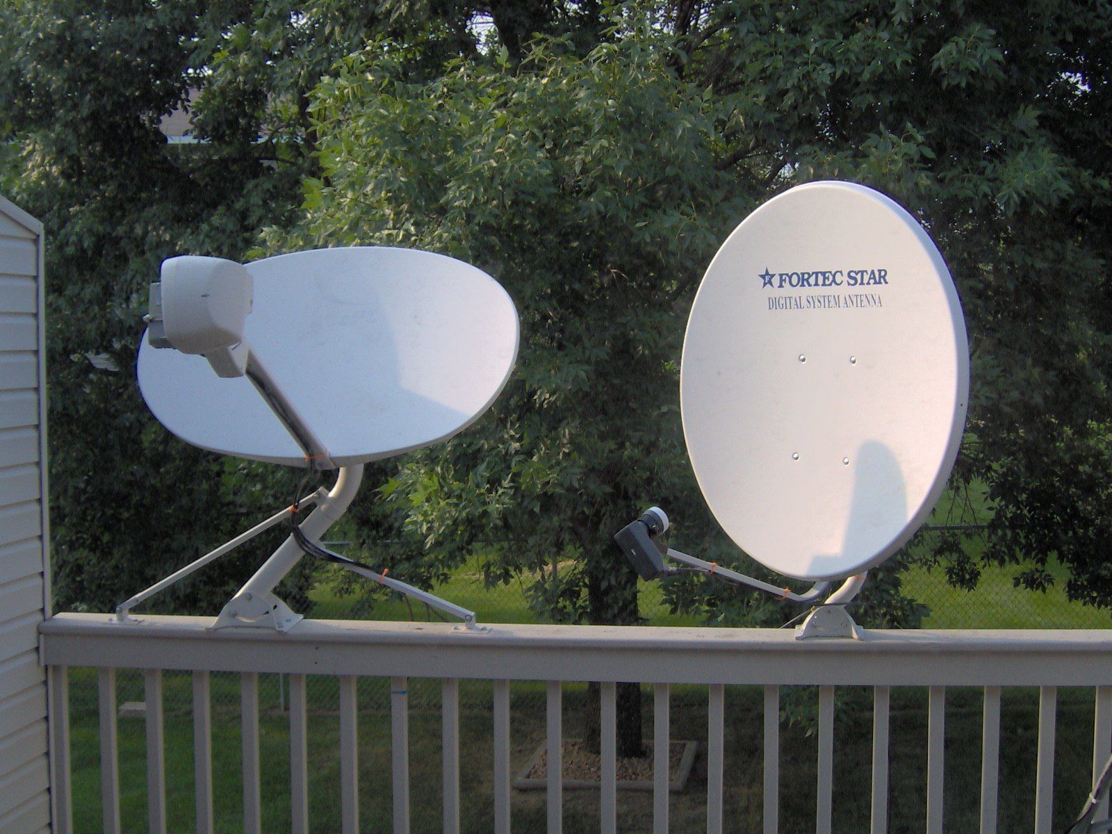

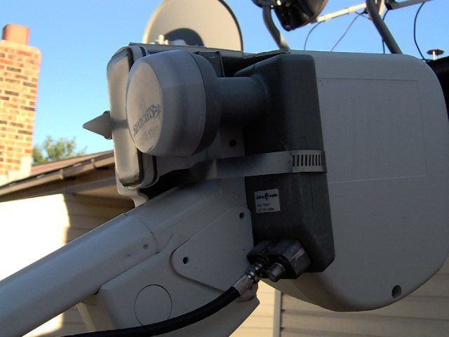

Here are a couple pictures of my old DirecPC dish (same size). 2nd PIC is a DBS LNB next to the rectangle one

I think the moisture cover pops off, I forgot now how I did it but I remember mine having standing water in it, when it was decommissioned from internet use (and still on the roof) You can take the extra weight off the lnb arm easily enough.
I had mine on G10 for awhile, was damned tedious to aim it too, but it gets a pretty good signal if you skew it right. It'll work just fine for G10, but choosing between it and
most any ol primestar dish is a no-brainer.
