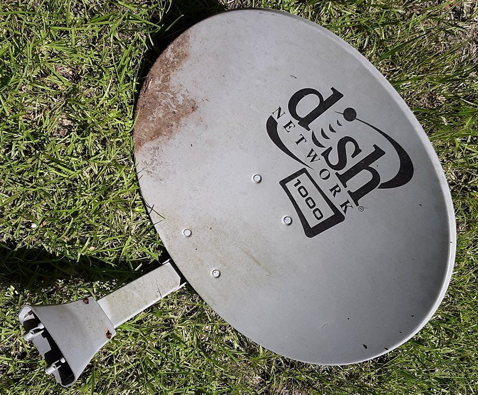

I have the old dish 1000 but no LNB. Would it be viable to resurrect this old dish? I'm finding a new Dish 1000.2 is cheaper than the cost of a used DPP LNB for this dish. Maybe I just looking in the wrong places.
I am not sure where you have looked, but Solid Signal has the 1000.2 Western Arc LNB for $44.99:
I am pretty sure that would fit the dish shown in your picture.
I didn't think that would mount onto my arm or work with 3 LNBs. I thought I would have to install a twin LNBF identical to what was on it originally. Dish Network took that one back.

I agree. The reflector shown on the dish in the picture is a Dish 1000, so it is capable of receiving all three satellite locations. I am not sure why it would be installed with a bracket and LNB for only 110 and 119. Maybe that was just due to using it with an old SD receiver. Anyway, simply changing out the LNB (and if necessary, putting a new bracket on the arm, to hold the new LNB) should allow it to receive all three satellites. So, there is no need to get an entire brand-new dish.
It's not; he's using a single-LNB Winegard. That is a spare dish Happy Jack has which is missing the LNB (and the LNB support arm), so it's not going to be that easy to add stuff.

I understand that is what he is using now. He was asking whether it would be possible to use that old dish instead. Then he said that it originally had a twin LNB on it, before Dish took that LNB back. I was confused, because I used to have one of those original-model Dish 1000's, and the LNB bracket had two slots for holding LNB's: one slot to hold the Twin LNB (110 and 119, which was held by two screws) and one for the 129 LNB, which was held by one screw. The bracket shown in the picture only has one slot, with places for two screws, not the three total screws that I remember. It is hard to tell how wide that slot is just by looking at the picture. So, it is either the bracket for a Twin LNB (110 and 119 only, with no place to put the 129 LNB) or it is the bracket for the newer-style Dish 1000 LNB's that integrate all three satellites. Either way, the dish itself has the proper reflector for all three, so he would not need an entire new dish. He had been saying that the places he was looking, it would be cheaper to buy an entire new Dish 1000.2 instead of just the LNB. That is not the price range I saw when I was looking. So, just the new LNB (or if necessary, the new LNB and new bracket to hold it on the arm) would still be cheaper than buying an entire dish, if you can find a place that sells the LNB cheap enough.
