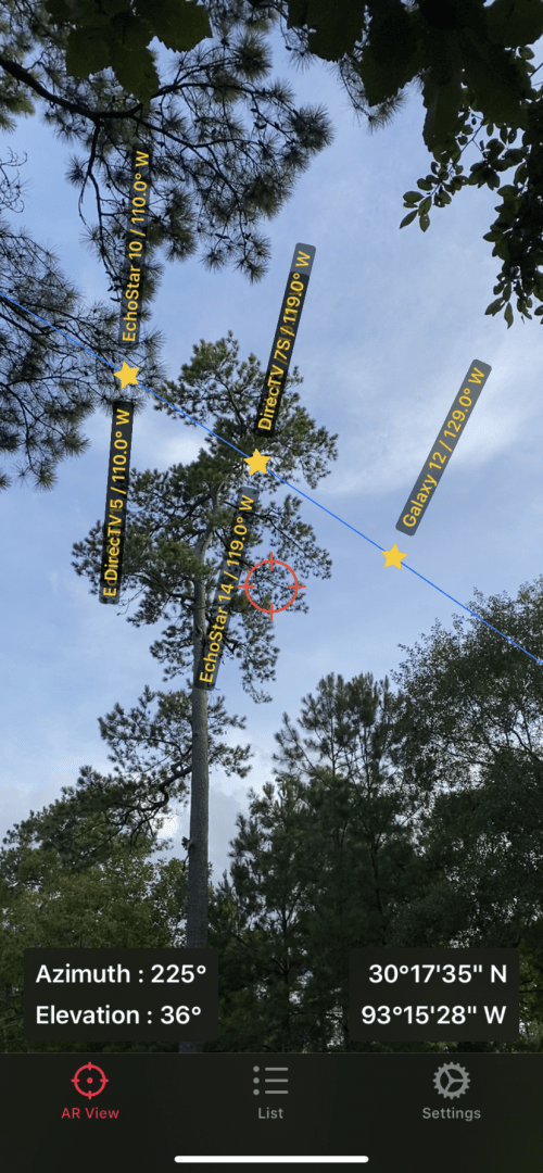

New member here. Quick question. I do a lot of RVing with a 1000.2 with western arc for 110, 119 and 129. I have a favorite camping spot that is not ideal line of sight. I can move my portable dish numerous locations and I can either get only 119 or I can get 110 and 129. My question is can I add a second single LNB dish with some sort of combiner ot switch to my set up and put the second dish where I have clear line of sight for 119 and get 110 and 129 off of the hybrid LNB and 119 off of the dish with the single LNB? Or is it as simple as hooking a second dish to the extra port on the hybrid LNB?
Also if this will work what dish do I need to get for the single satellite?
I have a tough time understanding how that is possible since 119 is right in the middle. Did this work for all 3 the last time you used it? I am suspicious of the center LNB...
This can be done with a switch, yes. But depending upon whether your LNBs are DP or DPH, the type of switch you would need would be different. What receiver do you have?
For a 1000.2 Western Arc, you don't even need a switch. Just run the cable from the 2nd dish to the input (4th) port on the WA LNBF, then cable form the WA Dish to the Receiver, run a check switch
There's nothing wrong with my equipment. This is my line of sight. I cannot get 119 with this line of sight. I can move the dish various locations but as luck would have it no matter what I do I cannot get all three line of sight.

This was my suspicion. I figured that would work. What dish and LNB should I use for the second dish?
Any dish that can mount a single DishPro LNB.
