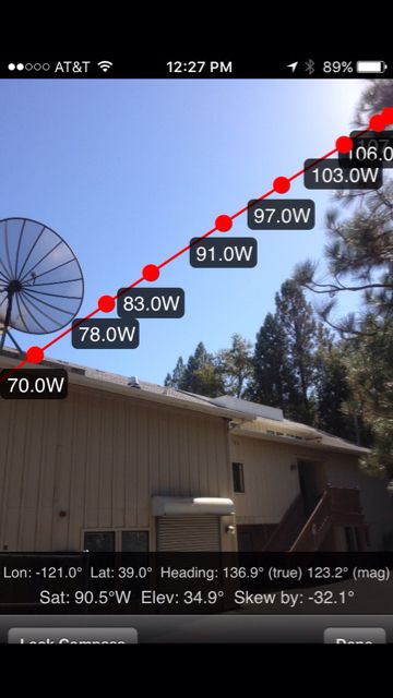

The digital age equivalent to the Bird Finder is installing the dishpointer app on a smartphone or tablet. The app overlays the selected satellites in the arc over the camera image.
This screen capture shows that the lowest unobstructed satellite to the east would be 72w and 103w is last satellite on the west edge before the tree blocks the satellite signal.

yeah the structure is north of the dish, so it will be behind it. I just wanted to ensure the dish was far enough away from the building to keep from hitting it when i go to the east and west end of the arc. though in normal use it would see more westerly use then east. according to dishpointer i should be ok with all satellites except maybe 139w as there is a tree in that area but according to the obstruction estimate it should be ok. doesnt mean the tree wont grow though.
I agree, the app is good, but there's one hitch here in WV. There are a lot of places in this state without cell service. I've used the app myself, and I liked it, but if you happen to be in a dead zone, it can't update the data. I don't have to worry about that with my Bird Finder. :)

In the case off no cell service or data, Dishpointer allows the user to manually enter the location longitude/latitude and use internal compass.
I have a similar app on my iphone though i havent used it at the location of the dish yet I did use dishpointer to kinda look and see though. I know to the east i have issues twards the end of the arc and there aint much i can do about it save a tornado coming thru and cleaning the town out. but the good news is according to lyngsat there isnt much id be interested in in that direction anyways. I can see for sure from 70w to 135w (maybe 137w depending on the tree) as there is nothing in the way. Also i did plant a pretty long pole. the center of the dish will be 9' off the ground so the bottom lip will be about 4' off the ground at my true south position. and i put the post 6.5' south of the structure so i am pretty sure it wont hit the building once i swing it over to 137w. even if i had the dish pointed due west there should be 1.5' between the building and the dish. Less once i put the 12' up. nearly finished stitching the tears in the panels, and beating the hail dents out and the new lnbf showed up today so ill finish these panels up attach the lnbf and hopefully by friday i can have one of my guys help me stick the dish on the pole. Tomorrow I hope to pick up the old satellite receivers of my dads, and hope it still works at least good enough to move the dish. pretty sure ill be able to bench test it in the shop so ill pretty much know weather or not ill have to order an asc1 right away or not. Im sure dad is smiling down from heaven right now cause he loved his c-band dishes.
