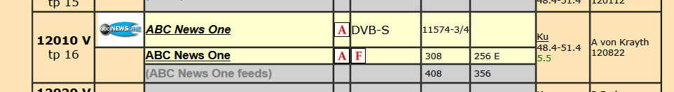

I go to Lyngsat (http://www.lyngsat.com/Galaxy-17.html) and look up Galaxy 17. Towards the bottom I find ABC News One 12010 V 11574.

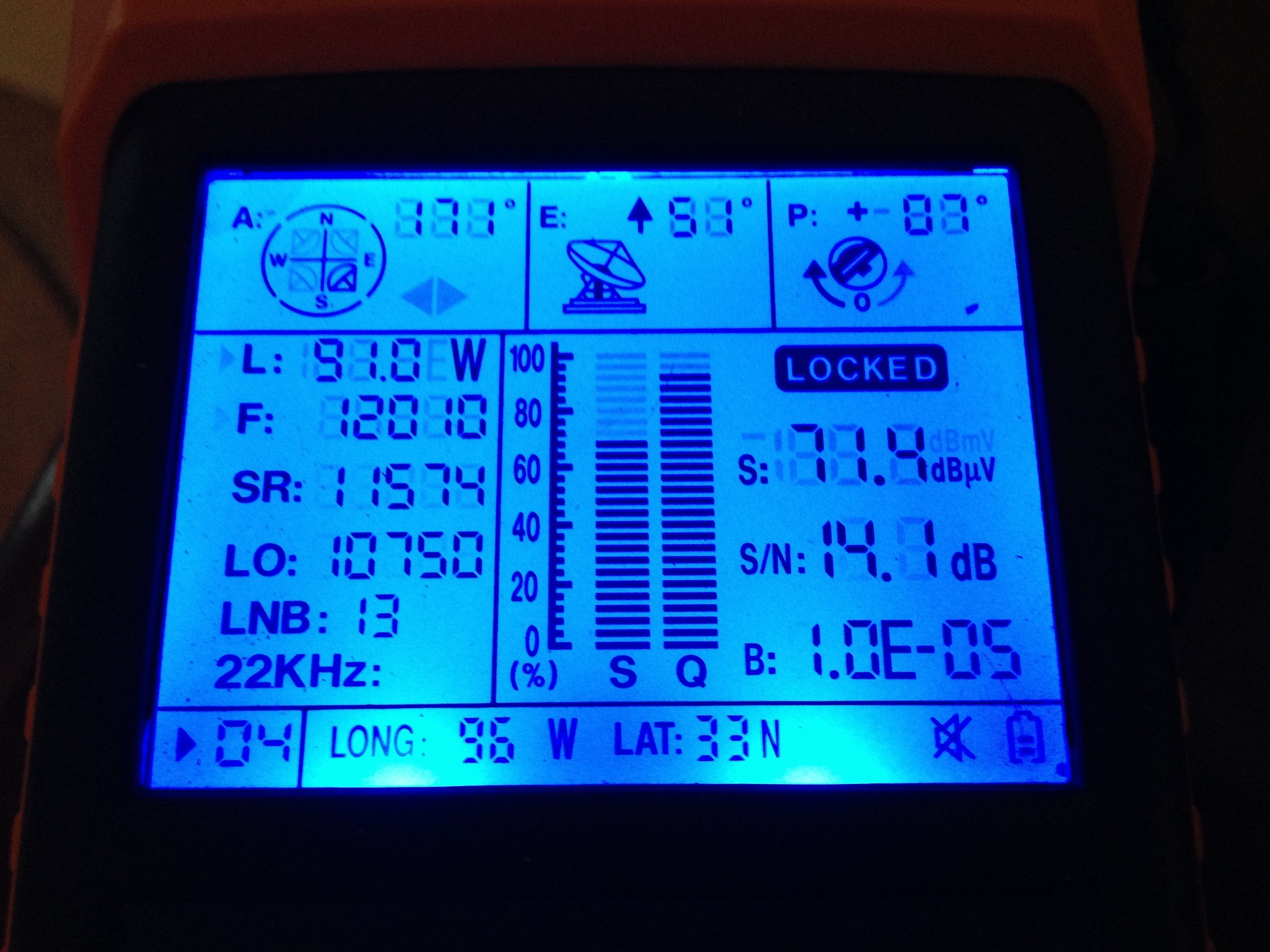

I program that into my Tracker Light and on the STB I select Galaxy 17, which moves the dish. I go to the dish to make sure it's actually pointing at something other than Galaxy 19. It is. Back in the house I power off the STB, disconnect the coax and connect the dish to my Tracker Light. Turn on the Tracker Light and bam - big time signal and quality - instant lock. Great - the dish is actually on the arc and pointing like it should.

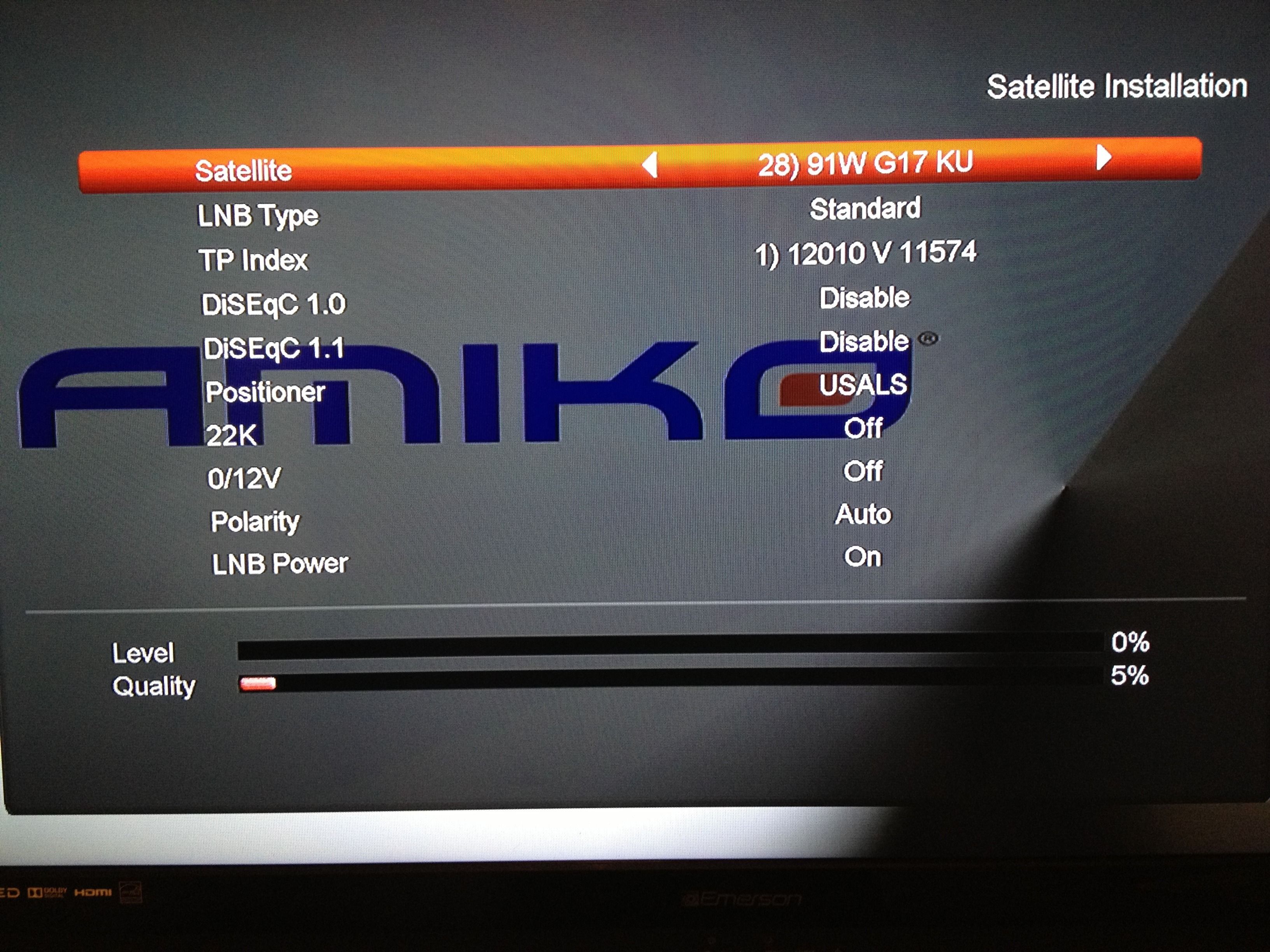

I shut off the Tracker Light, disconnect the coax and connect it back to the STB. In the STB the only TP for Galaxy 17 is not setup exactly at the same rate shown in the chart and what I put into my Tracker Light. The freq. is 12010 but the SR is 11575 not 574, but that's not enough to make a difference from what I've been reading. I look at the screen and 0 signal and hardly any quality - so it's obvious it's not seeing the signal. I go ahead and edit the SR to 11574 and try again. Still nothing.

I'm sort of getting frustrated at this point because I'm not understanding what I'm doing wrong here. Shouldn't I see the same thing my Tracker Light sees and when that happens I should be able to blind scan? Any ideas? At least I'm fairly sure it's not a motor or tracking issue.
UPDATE: So I went back in and just started blind scanning all the Ku birds, and low and behold, stations started coming up. I'm still not sure why the above didn't work, but I certainly am on the arc. As they say, if you first don't succeed, try something else!

I wonder what would happen if you took a portable TV with the STB out to the dish via a drop cord? If you're using a NanoHD, it would be very easy :) Sometimes the fault is in the cable run into the house.
The SR being 575 instead of 574 is ok, a lot of times they are off a little because of the LNB, skew, etc. Sathint actually lists the SR for that one as 575, not 574.
I don't have that receiver, so I'm not sure, but on my receivers even if not locked on a sat I get 45% for strength if all the settings are correct and a LNB is connected, in your picture it looks like the level is at 0%. If the level bar on that receiver is actually for signal strength, then it looks like maybe a wrong setting for the LNB or a cable problem. What type of LNB do you have?

Nope, same on meter at the dish or in the house. I've learned a new phrase - repeat after me - "Blind scan, blind scan, just shut up and blind scan". I think I was cherry picking too much. Just blind scan and go edit out of the channel list what I don't want.
The meters on the STB don't show any signal. Does the satellite meter show Signal Level and Quality inside the house or are you checking outside at the dish?
