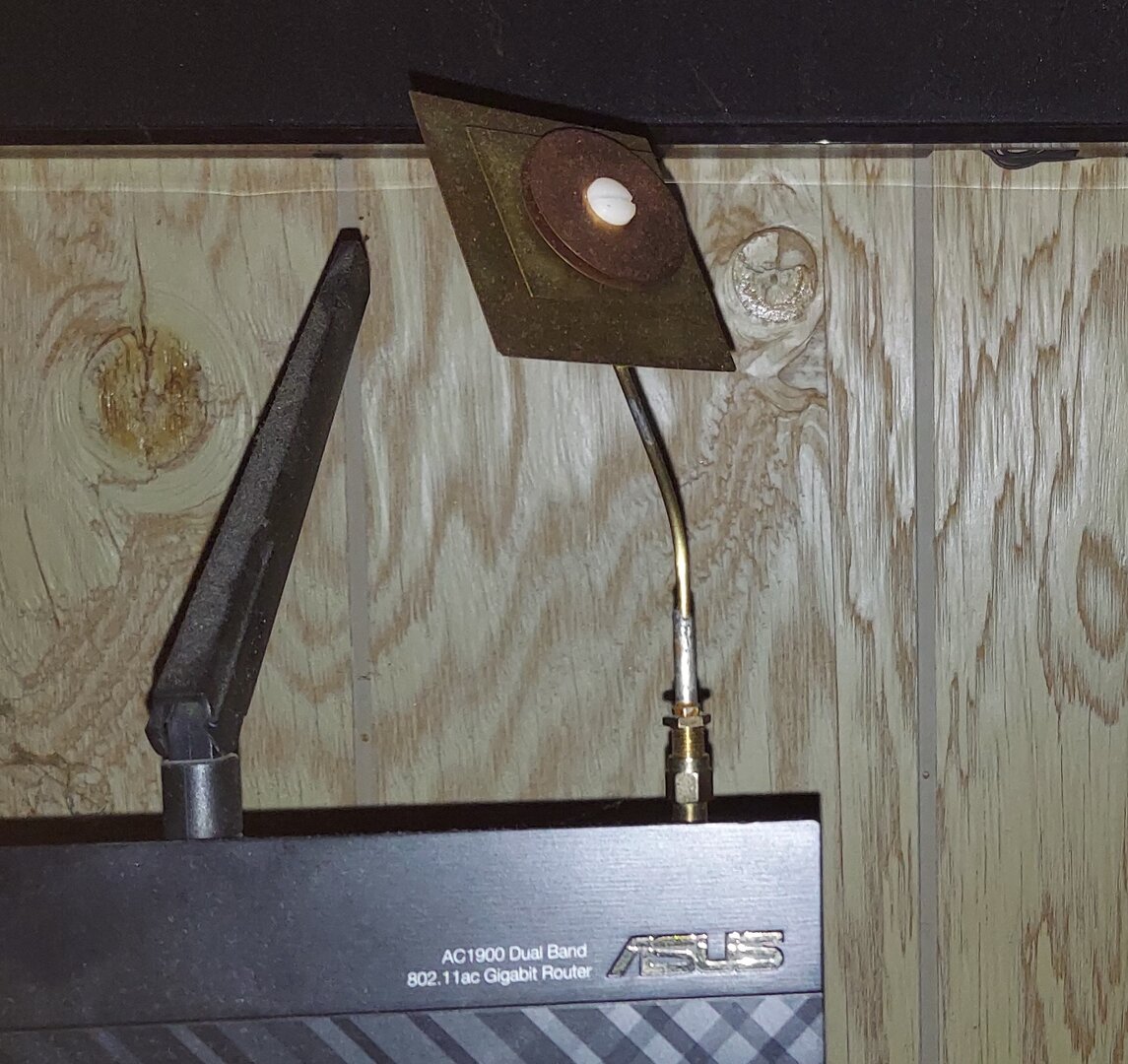

The little antenna I made for my router is for 5GHz. It beams signal across my house and upstairs. Through walls and floors. The signal is great and the 2.4GHz Wifi net is quite fast. Even signal from it outside is usable for an amazing distance using the stock antennas on the AP/Client router.
It kind of counters my suggestion to use the 2.4GHz Wifi net for your application because of the wall/distance thing.
But shows that a directional antenna will do what the stock omnidirectional just can't so well.

Nice. But not all "routers" have external antenna jacks. For instance, the CR1000A cable modem / router does not. Used by Verizon FiOS and I believe a few others.
You are right. But choosing the correct router/range extender for your access point should include if it has detachable antennas. I just use old routers and install dd-wrt and Fresh Tomato firmware.
Again you are right. Many ISP routers do not include visible or detectable antennas.
