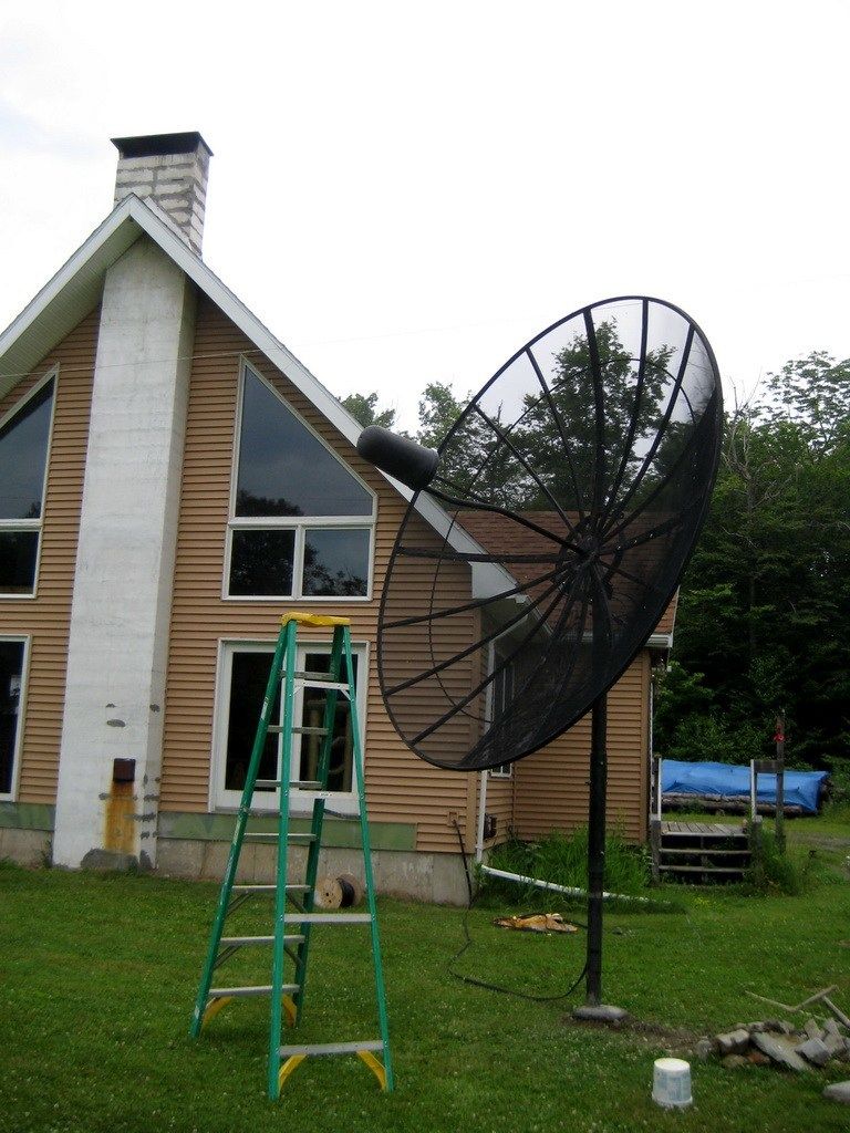

OK, I have the 922 all hooked up. The actuator moves the dish, the polarizer/servo motor works, the counter counts up and down as I move the dish. So I am sure I have it all hooked up correctly.
I put the dish angle at 74 degrees on my protractor for C3 (translates to 16 degrees). I spin the dish mount around on the pole back and forth looking for signal using my SkyPeaker Trio as well as watching the TV thru a window. I am unable to find any signal. I even changed the angle to 35.7 degrees for G16 and turned the dish to aprox location of the satelite. Still no signal.....I even was using Satelite finder website with google earth map showing me the direction relative to my home site. Could it be that the LNB is bad? I know the servo motor is working. I can hear it and also was able to see it change polarity. Do feedhorns go bad? The sat guy who I bought it from said he had to clean out the end of the feedhorn as it was full of bee nest.
I am at a loss and getting frustrated!
Nevermind........I found CSPAN on channel 7 on satellite C3. I also have found some programming on G16 at channel 16 & 17. I have X4 programmed in (same position as G16) but I have no DC green lite to show a lock. Is this because I have not called for programming yet? It appears all set because the channels start at 201 and goes to 900+.
I have a few sparkles on C3 but that is due to my shooting thru the trees. G16 is clean.

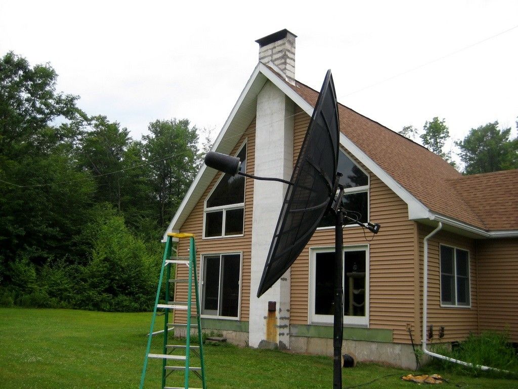

I am still learning. I have a dual feedhorn on the 10 foot dish. The KU LNB is bad and will have to be replaced. I was told it was hit by lightning. Do I use the KU band LNB on this dish or is it best to get a 90cm dish? I do know that the dish needs to be in perfect tune to use KU. I never had much luck using it on the 922. So, I was thinking of getting an MPEG receiver and hooking the KU coax to that.

That dish appears in good condition and should work well if the mesh is very fine. Perforated dishes such as The 10ft Wiengard Pinnacle I have work very well on C & KU. Get a good quality KU LNB and I think it will be fine. KU is not that much difficult than C band and if you have that aligned properly all you may need is the LNB.

Who made this Dish ??
