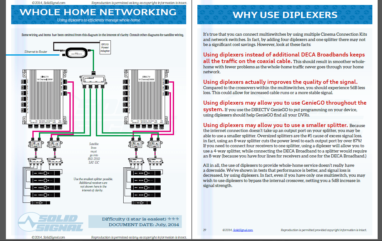

Just google swm 32 diagram and should find many ways to do it, here is the "official way"

You would need 2 broadband DECAs and as long as they are connected to the same router this should allow whole home across both SWM 16s
having never seen a SWM setup with more then 16 tuners, i would imagine the least problematic way would be to use 2 deca's. are you saying you could diplex the two 16's together and just install a single deca?
This is from solid signal, it shows it quite well, it will also work via genie to distribute the internet as well, just terminate the port on the 4 way splitter.
That is interesting. I always seem to have issues with the 2 deccas seeing each other as they run through my home network.
I wonder if there would be any benefit using a separate router to keep all the ip addresses on a separate network ?
