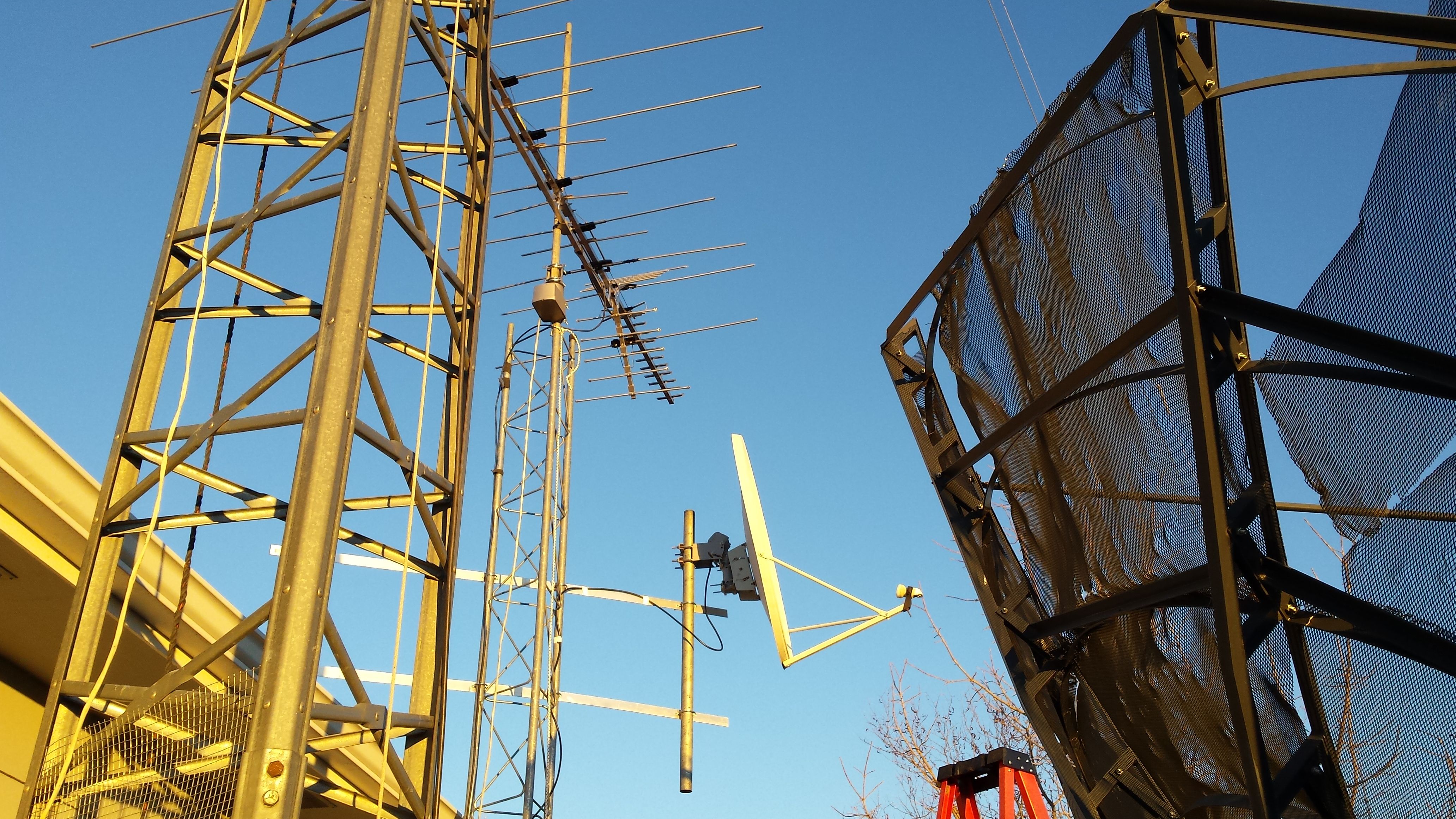

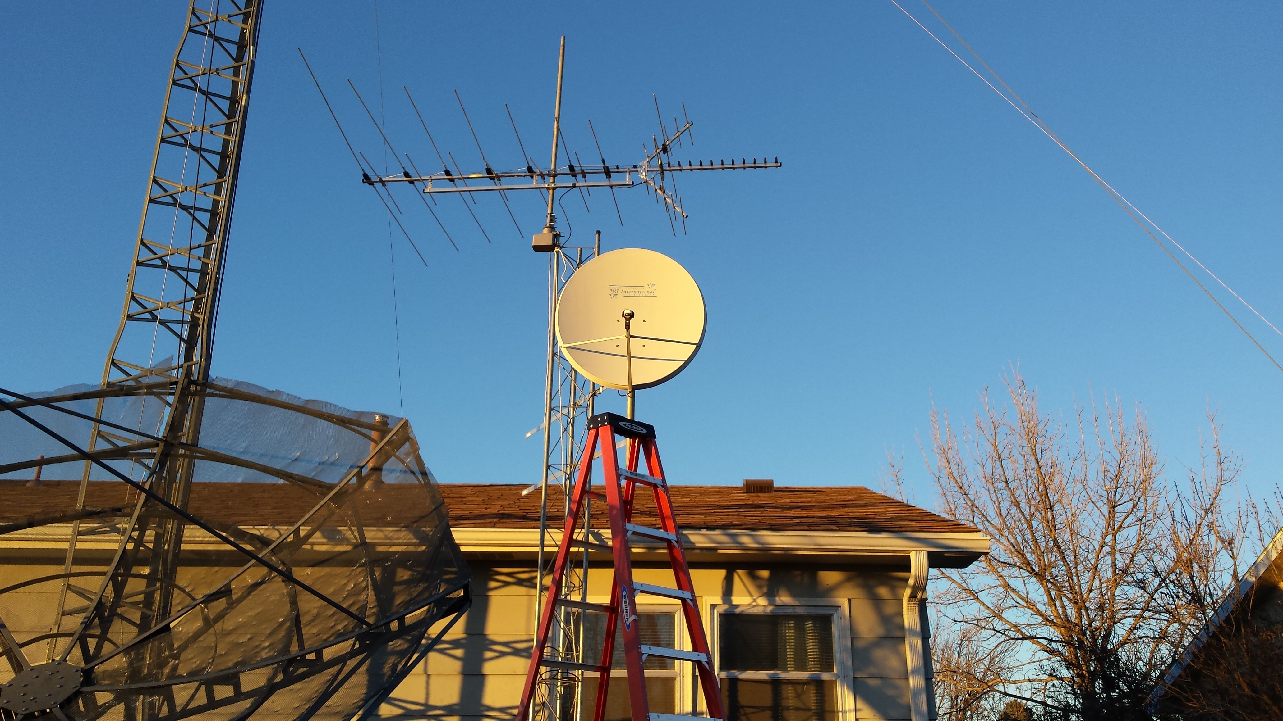

Yesterday, I got mine up on the tower before the storm showed up. I opted for the aluminum angle for the arms but I'm not sure if it'll be reliable. Some crunching of the aluminum occurred while tightening. I considered hanging on the arms for a test but since it's up 15 feet above ground I decided not to do so. :eek I mounted the motor but haven't put the dish up. Anyway, it would've been a "good" test to see if anything would shift. The antenna weighs a lot less than me. :) But then there's wind load.......
I wonder if I should have got an HH120 instead since this antenna is actually 99x90 cm.
Making progress. Was running out of daylight so I put the alignment off until tomorrow.
