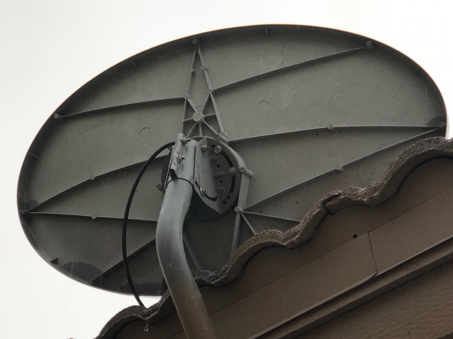

If possible, please attach a photo, taken as close as possible, of your current dish.

Here is an image on my current dish, the back of it
OK!!.....I hope some of the other posters in this thread will confirm, but I believe that your dish is most definitely a 60e dish.
Here is what you can do from here:
MUST DO: Purchase receiver: 600 or 800 if you do not want to record programming, otherwise purchase an 630 or 830. Try to avoid purchasing a used receiver as there can be complications.
OPTIONAL: Purchase a 60e xKu LNB and replace the LNB that is currently at the end of your dish arm. If you do not do this Shaw will continue to attempt to contact you and ask why you have not made the change.
If you decide to purchase a receiver that has recording capability you will need to run a second coax cable (the thin black wire that can be seen in your photo) from your dish to the back of your new receiver.
Once you have done these things you should be good to go, but you can always post back here if your run into trouble.
