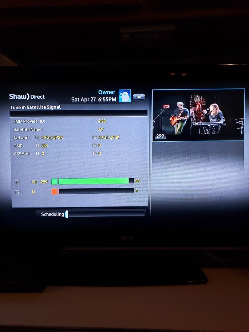

31,162,88 deg is Cochrane"s settings. Which channels are you picking for both sat's?
I am getting great reception on one satellite... Receiver signal strength has it tagged as T1
I am not getting anything on the other T2, as I can't get it to stop fluctuating up and down.
Do you have a pvr with two cables going to it? I would think that T1 and T2 are the receiver's tuners. You would have to pick a channel on F2 satellite to check signal there. Been out of Shaw for a few years, so menu's are different from what I would recall.
Catamount
Agree with all that catamount says. They are the two tuners (not the two satellites), and it appears you don't have a second cable running from the dish to the second tuner. The screen you show has both turners currently on F1/G1 and the second tuner does not appear connected (or isn't working correctly if a good line is attached). Change the channel (manually enter a channel number) until the T1 tuner says F2 (try 002) .

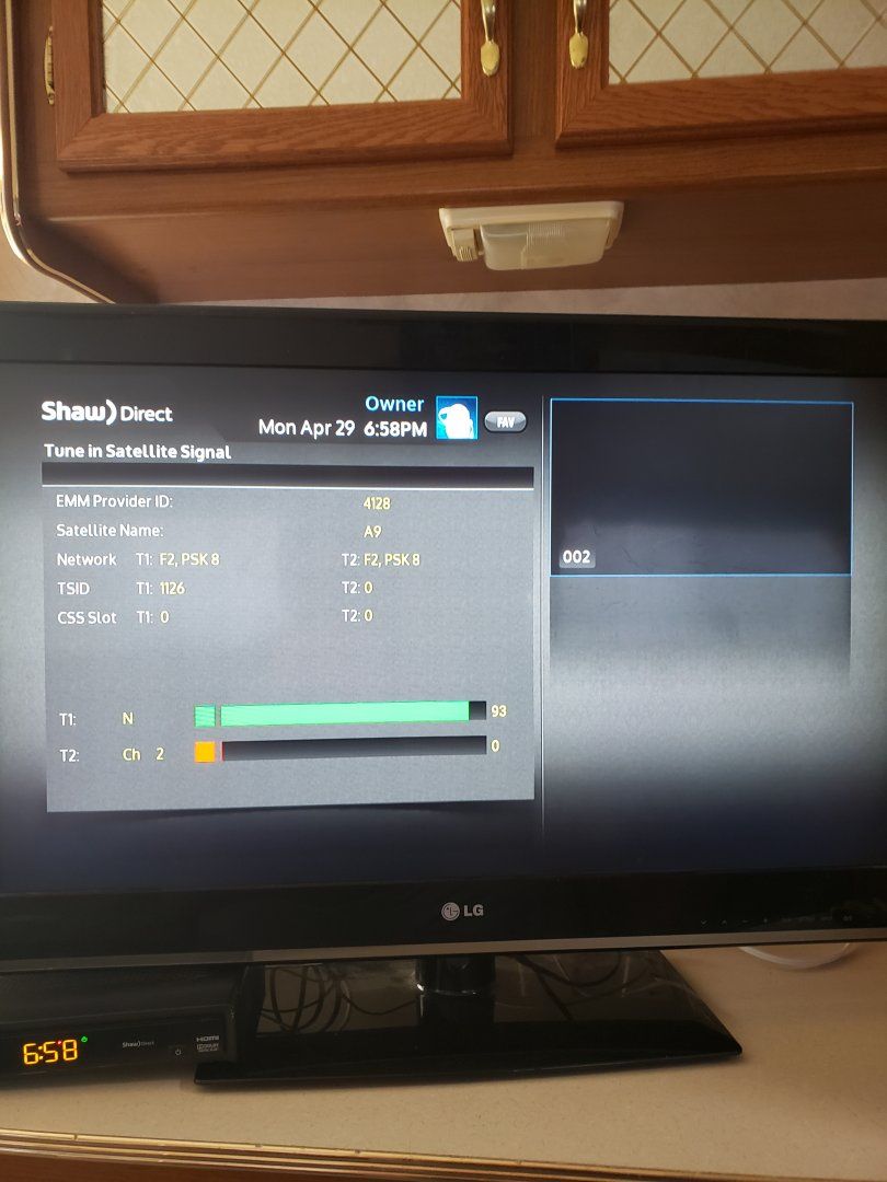

Yes, your right... I only have 1 cable connected at this time. Should I not be able to receive all channels through the 1 line tho even tho I have a PVR, but not using it as such?
The receiver expects both lines to be connected. Did a check on my system (looks like you have the same box as me HDPVR630) and it switches tuners with every channel change. The screen you show shows it is trying to find the channel on the tuner not connected. The other tuner show a strong signal for the F2 satellite, so you do have the dish lined up correctly. You can check this out yourself by manually entering channel numbers while still in the Tune In Satellite Signal screen. Since this seems to be the case, every other channel you enter in won't show up as it will switch to the second tuner not hooked up.
NOTE: channel 002 is active in my line-up which is the Classic Channel line-up, don't know which one you have. If you are suppose to get a channel there, you can manually enter in another channel number, and then another, and then 002 to see it (with the tuner you have activated).
EDIT: If you only want to use one line in, go into Preferences, then Tuners & Storage, and change the setting Single Tuner Mode from Disabled to Enabled. Of course, it will restrict viewing if you do any recordings (there is info that explains the restrictions with Single Tuner Mode).

Thanks very much Keith Brannen.
I did as instructed and I am now receiving all channels. I did not know of this disabling PVR function. That did the trick and we now can view all our subscribed channels.
