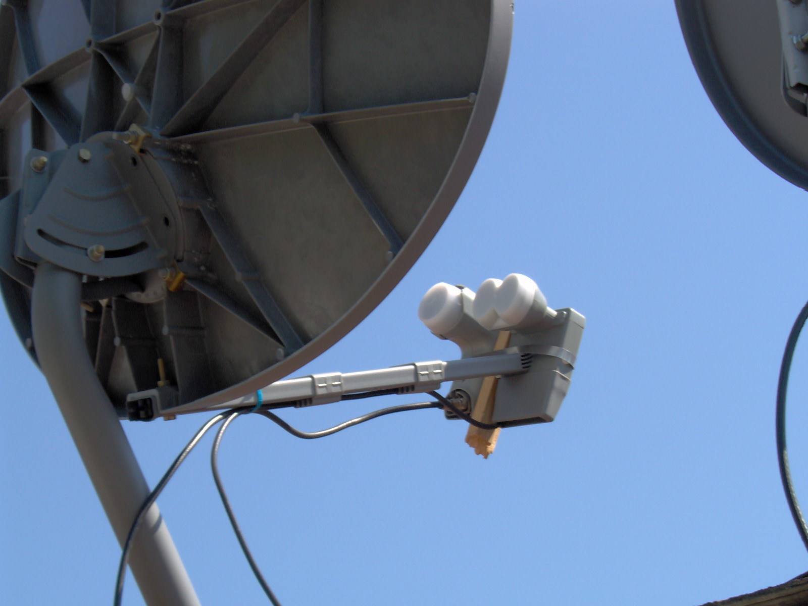

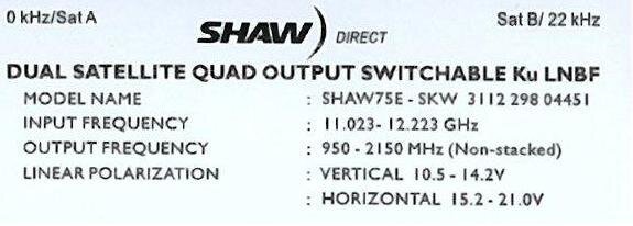

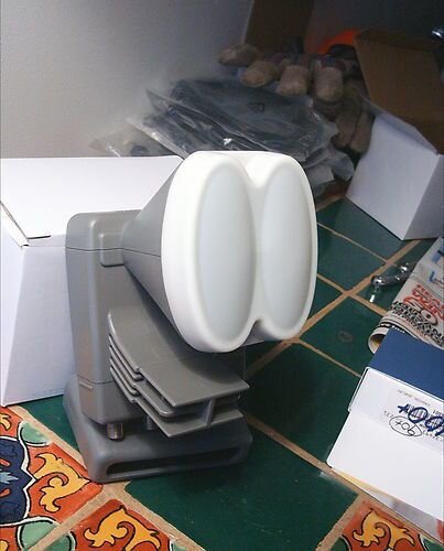

here are a couple pics of the LNB's by the way
1st is a quad (non stacked) on a 75e dish (this was mine at the house)
2nd is the new XKu LNB...note the slight difference
3rd pic is a closeup of the older LNB (the LNB to the left was for 119 for my Dish sub)
also on the back it will say the type too
