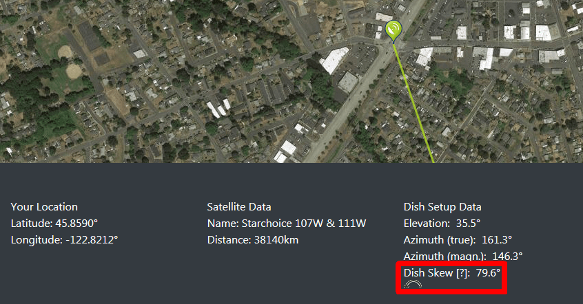

You didn't mention skew and I noticed that dish pointer doesn't seem to have skew either.
If you choose a multi-satellite dish as showtime recommended, dishpointer will show the appropriate dish skew (not to be confused with LNB skew). If you use only one satellite (such as Sat B), dish skew doesn't make sense as you aren't trying to hit multiple satellites.
The rotation arrow points counter-clockwise (as viewed from the scale side of the dish).
