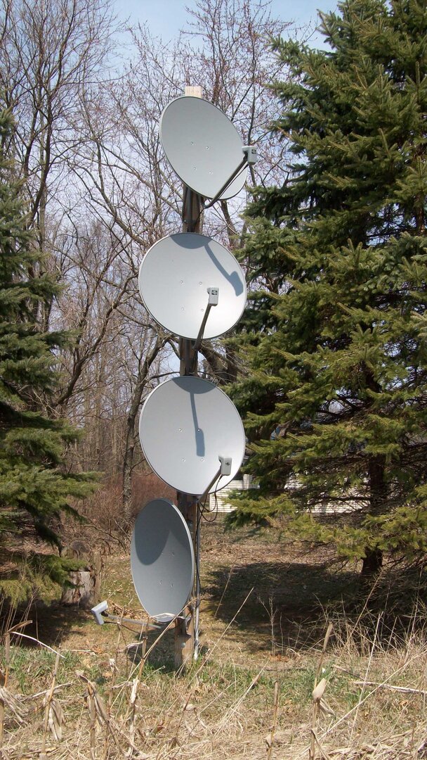

Hi, I have a 4 separate LNB/reflector setup feeding a DPP44.
It was for 61.5, 72.7, 77, & 129.
Now with 77 decommissioned (total surprise to Me), what would be the next best choice?
Too cold to change now, but in 4-5 months yes.
I was looking for a transponder / channel map, but all I see still have 77 listed (hey it's only been ~ 2 weeks).
Maybe best to wait to warm weax and find / compare maps then?
Thanks

How on earth are you getting a LOS on the bottom dish?
From SW MI, 129 is very low to horizon.
Even transponders get a high 30s signal - not bad given distance and atmosphere.
Odd ones get upper 60s !
I do have to clear weeds a couple times each summer.
Even transponders get a high 30s signal - not bad given distance and atmosphere. Odd ones get upper 60s !
BnS, I am having trouble understanding how that is possible. Is there some circularly polarized filter between the dish and the satellite? Surely not. Something wrong with the LNB? Unlikely too, but more plausible. Is this a regular DP LNB? If so, one of the bands is stacked on top of the other. I would guess that the higher frequency band is the one handling the even transponders. I'll bet something is not passing the higher frequencies as it should. What coax are you using?
All 4 are standard DP LNBs. I suspect the eirp of the evens is different than odds.
Maybe evens are affected by atmosphere more than odds, but RF is voodoo to me.
Everything is RG-6 that I crimp ends on.

I suspect the eirp of the evens is different than odds. Maybe evens are affected by atmosphere more than odds, but RF is voodoo to me.
Well, for someone who thinks RF is voodoo, I'm surprised you mentioned the EIRP!
Anyhow, I wanted to mention that the atmosphere is almost certainly not the culprit here. That was essentially my first proposal above (circularly polarized filter like the atmosphere), which I regard as the least likely. Either you have crappy or damaged RG6, or RG11 is in order for such a long distance to your receivers. What is that by the way?
